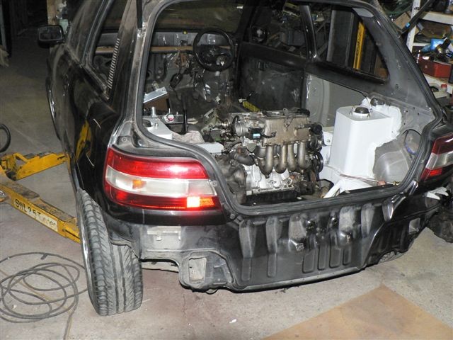

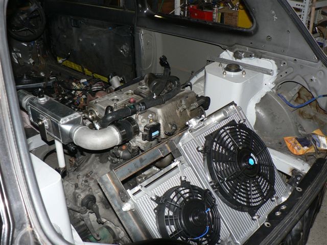

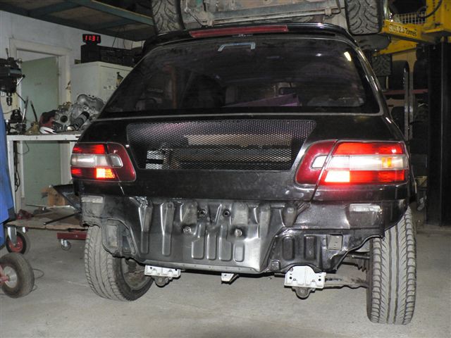

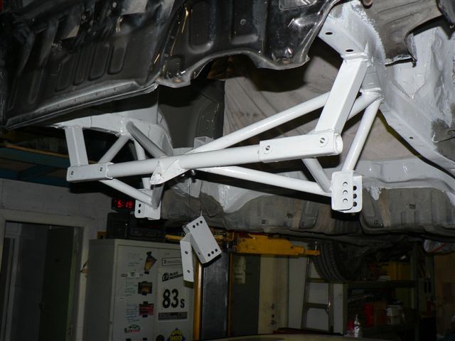

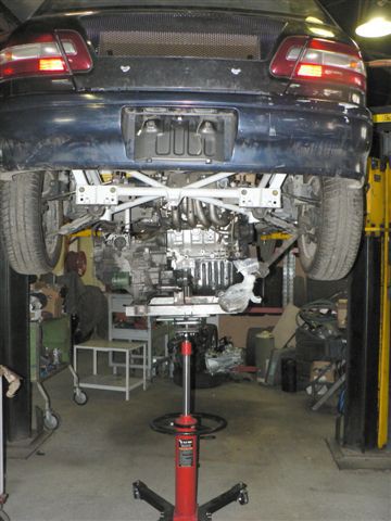

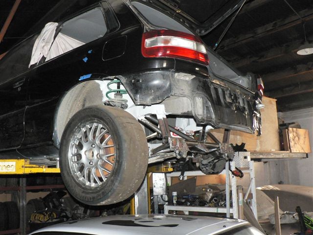

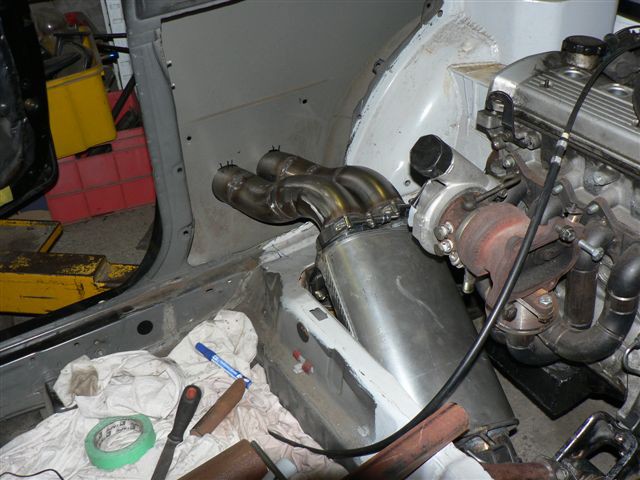

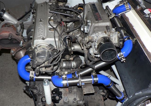

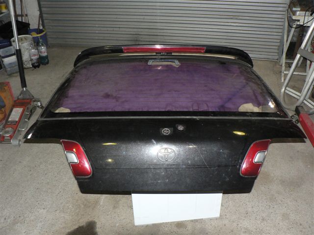

Here are some more pics of my project , the first one is the rear motor in place , the next is the start of the rear radiator install. then the before and after of the rear hatch with the vent in it. finally there is how I get the rear motor in and out and lastly the water pipes on the rear motor.

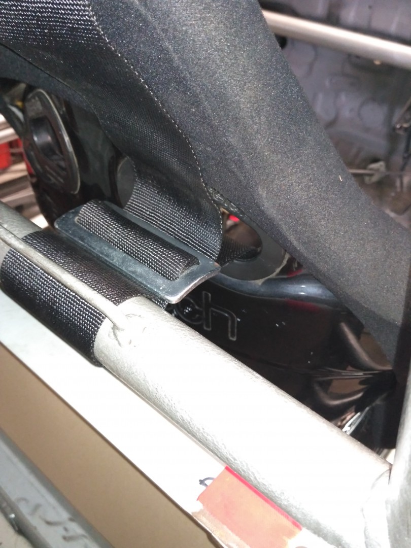

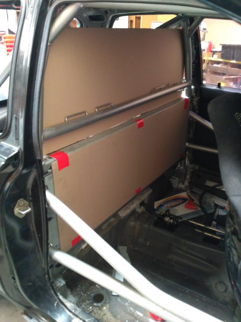

More (slow) progress has been made , I have finished mounting the drivers seat to give my head more clearance from the cage and make it safer ( I hope ).
I have been building a wall , not to stop illegals or anything , I'm more interested in not being asphyxiated / burnt when driving , lots of CAD going on here , will make wall from something more fireproof
As can be seen here , there's not a lot of room behind the seat , just enough for the harness

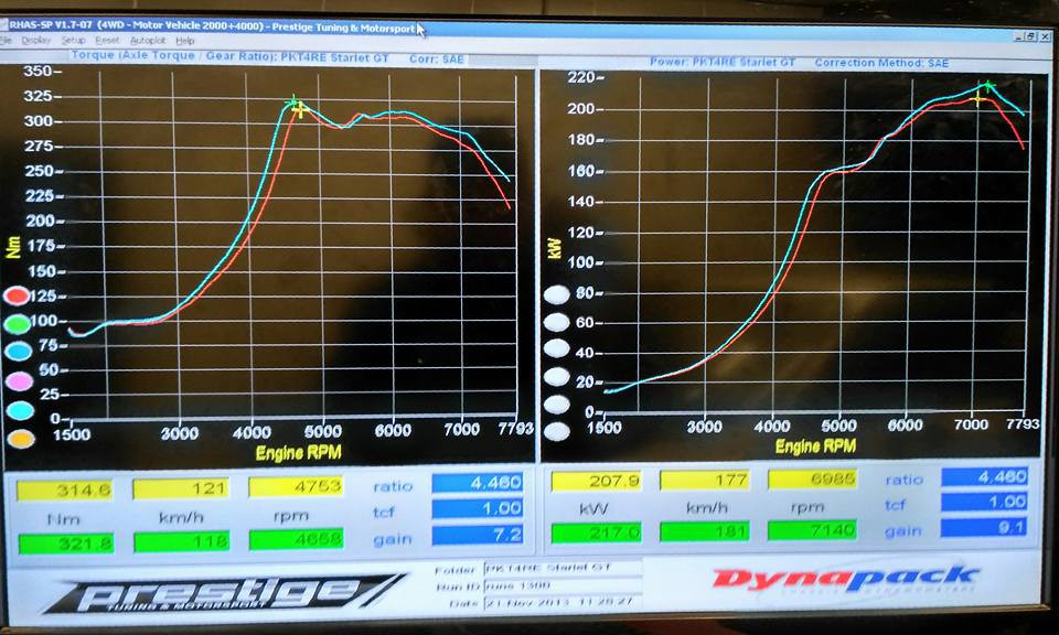

I finally got the new project motor on the hub dyno and tweaked the tune a bit , I'm very happy with it , now I just have to get another GTX turbo for the other motor , or probably just stick with the turbos I have . . . . for now

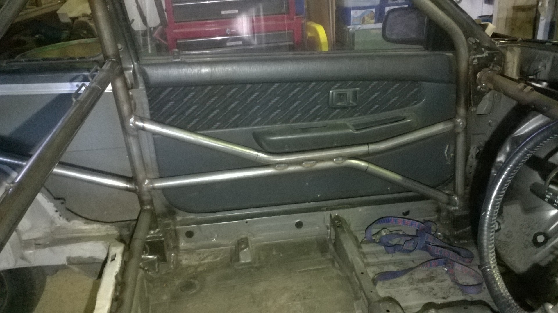

The cage is finished
