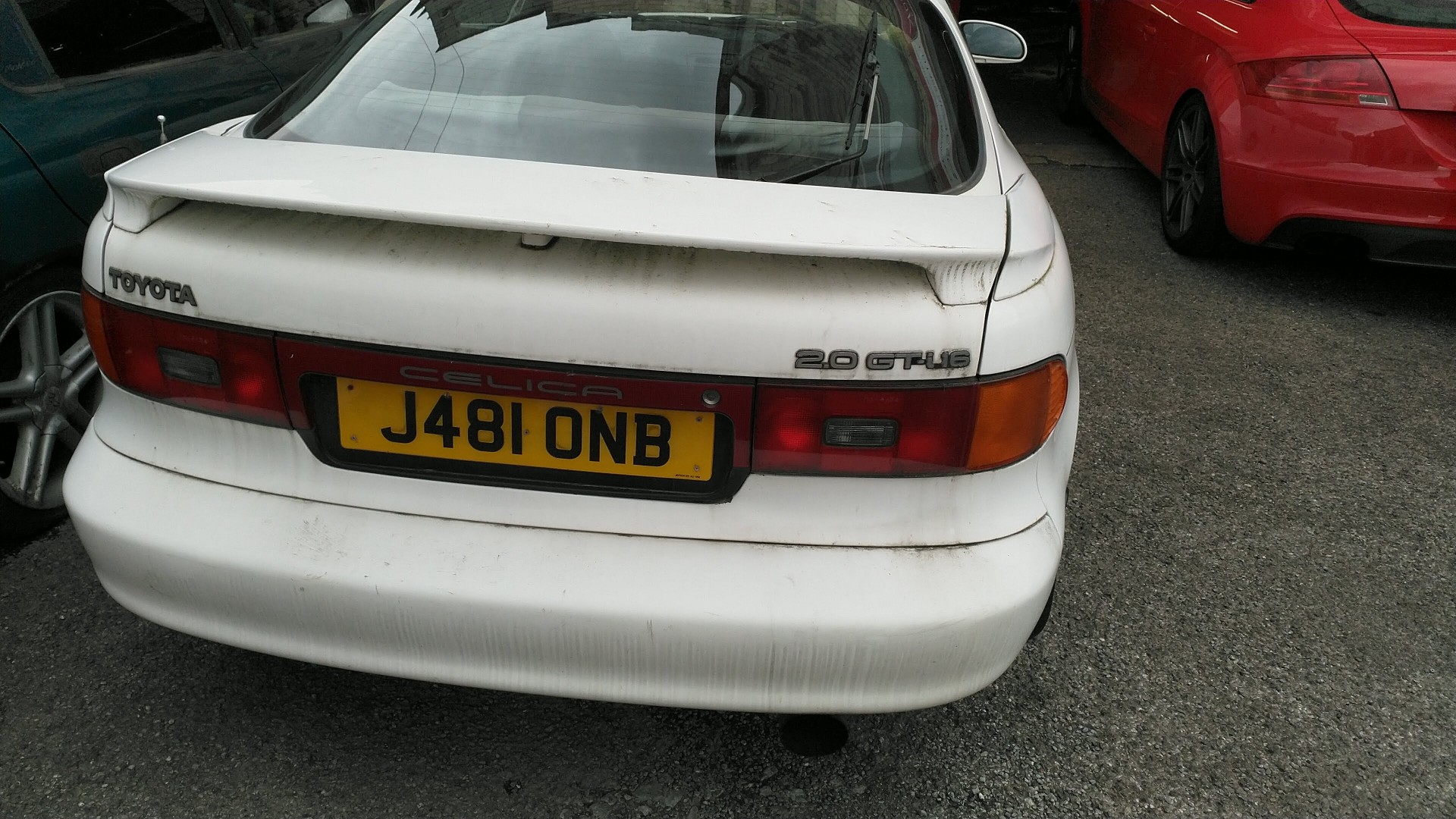

Nothing new to report on the Celica. I haven't been round to the local garage.

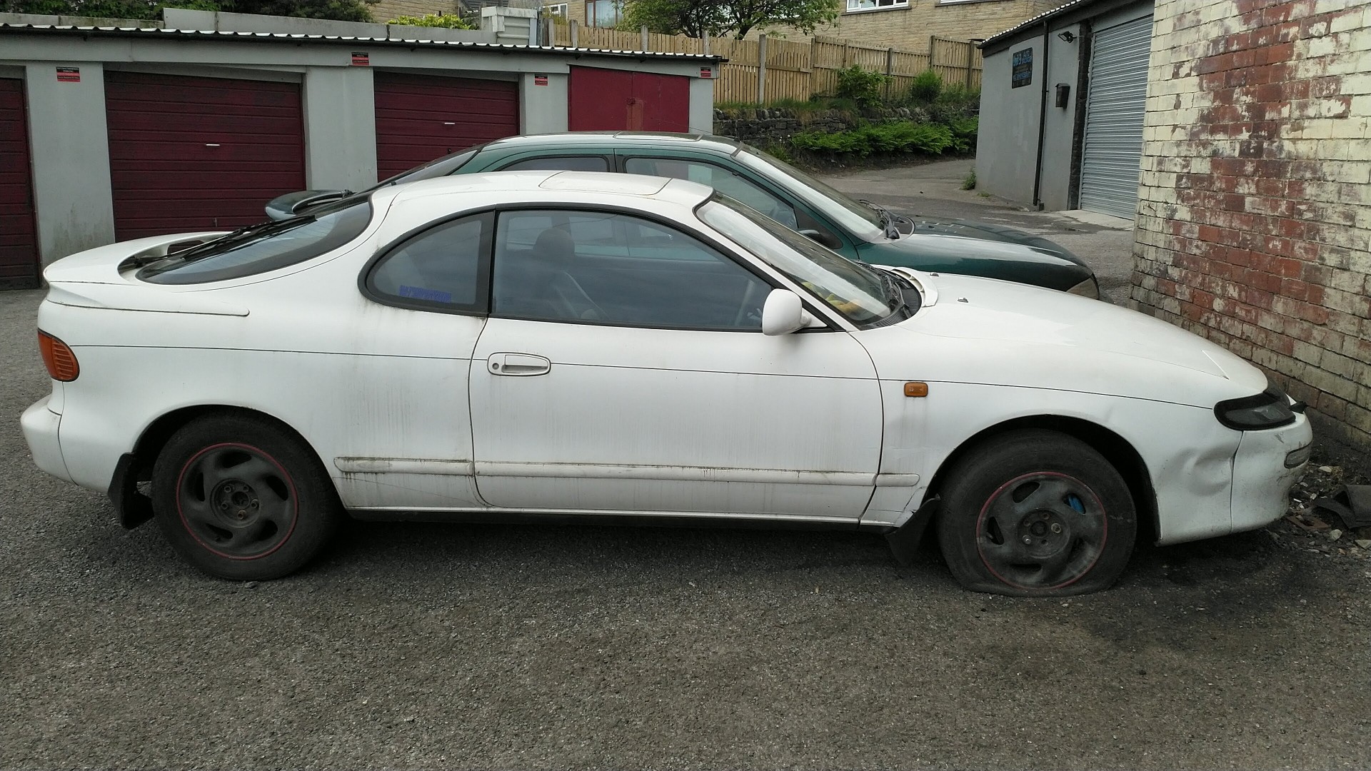

I decided to bite the bullet and I've applied for the V5C for the Celica. I'm just playing the waiting game on this one. I know the V5C isn't proof of ownership (I can get a receipt from the garage so I'm covered in that respect) but the car can't be taxed without it.

I've got the V5C for the Celica so I'll be going round to the garage to do the deal. I've already ordered a new battery from Euro Car Parts. I'll tip some petrol in, pump up the tyres and get it round to my workshop (a single garage in reality).

Got the Celica home and it has got some awful tasteless mods. The exhaust is too loud so that has to go. The wheels look terrible and need to be repainted or replaced. It will need a service and the brakes overhauled. I've replaced the blue LED sidelight bulbs with some filament bulbs (left over from the LED light conversion on the BMW). I'm planning on taking this car back to as close as stock as possible and sell the parts I remove.

I've ordered a lot of parts for the Celica including a new exhaust (the old one is ropey and has an aftermarket back box), discovered that the non-working headlights are HIDs, and I've decided to strip the paint off the wheels with some paint stripper I bought from Screwfix.

More work has been done on the Celica. I've carried out the engine service, fitted the heat shield for the exhaust manifold, bought a spare wheel for £8 on eBay, fitted new rear brake pads, replaced the broken front wheel stud, removed the HID headlight kit and got most of the paint off the wheels. One major fail was that the exhaust was missing the rear section. I've contacted the seller and they're gonna send it out to me.

I've painted the wheels on the Celica and they look better than before. They're far from perfect and I just need some replacement tyres. The rear section of exhaust has arrived. I bought some nuts and bolts from my local Halfords and after finding some washers in my stash, I've got everything I need to fit the new exhaust. I've just uploaded part 5. I've got 2 more videos ready to upload, 1 video to finish and part 9 will be fitting the exhaust. I had a couple of H4 bulbs so I fitted them and the headlights are working once again as Toyota intended.

Replacement tyres have been fitted so that's the wheels done. The exhaust has been fitted which is a LOT quieter. I've replaced the HT leads, rotor ram and dizzy cap. There is a lack of power at low revs and with the ignition being 100%, I'll need to investigate elsewhere.

I've set the ignition timing, replaced the fuel filter and it still isn't running right. On a more positive not, I've faxed the sunroof. The cables were all rusted up. I had to dismantle the entire sunroof and used lots of penetrating fluid to get it all freed off and it then had copious amounts of white grease to prevent a repeat performance.

I'm gradually getting closer to finding out why the Celica isn't running properly. It is looking like either vacuum hoses or the fuel injectors. I also need to do a compression test. I discovered an error code relating to the Air Intake Temperature sensor. The code has been cleared and hasn't come back. I also had a couple of ABS codes one of which I've managed to get rid of (NSF sensor). I've improved the brakes slightly by reseating the vacuum hose for the servo.

The compression test showed healthy figures so the 3G-SE engine that's in the Celica is in good condition. I replaced the ECU temperature sender to make sure the ECU was getting the correct information (the gauge has a separate sender which does work) and it hasn't made any difference. It was a cheap and easy job and is one more thing eliminated. I'm going after the injectors next.

I pulled off the top cambelt cover to check the engine timing and it was fine. In doing so, I ripped off the capacitor that's situated on the altenator (it supresses radio interference) and the end of the loose wire shorted to earth and blew the main 100A fuse causing a loss of one of the live feeds to the igniton switch. It took me 4 episode on my own YouTube channel to reslove this. Fortunately, it only cost me a couple of quid on eBay for a pair of replacement 100A fuses.

The Celica's brakes were binding so I managed to free them off. The front calipers had to be removed and compressed air got the caliper pistons out. Once they were cleaned and given a thin smear of grease they were fine. I've added some fresh petrol and some injector cleaner to try clean out the fuel injectors. I've also fitted a new front number plate.

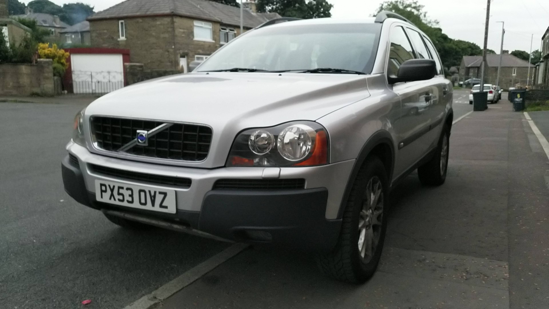

2 years later and the C4GP has been replaced with a 2003 Volvo XC90. An accident in June 2021 wrote the C4GP off by the insurance as "beyond economical repair".
The Dolomite is quietly rusting away and refuses to start. The E36 suffered a bit of damage bus is still road legal. The Celica is finally running a lot better since I changed the fuel pump. Just the ABS and a rust hole in the sill and it will be ready to go through the MoT.
