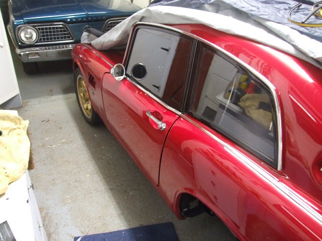

into the tenth year and still a way to go. as per the project Binky I want it to look fairly understated.

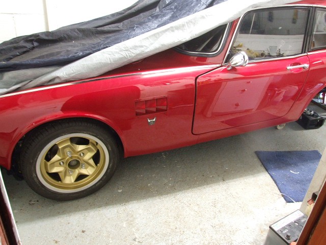

the Porsche wheels are for track days. I have a set of standard wheels for road (the S800 is the same 5x130 PCD as the Porsche)
no it isn't photoshopped. and the wheelbase is shorter than the Mini
that is the unmodified, just slightly massaged, transmission tunnel with the six speed gearbox lurking underneath. S2000 gear lever modified to mimic S800 lever and the original S800 4 speed knob fitted.
yes it is that small.

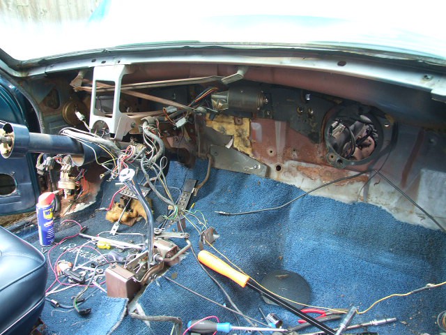

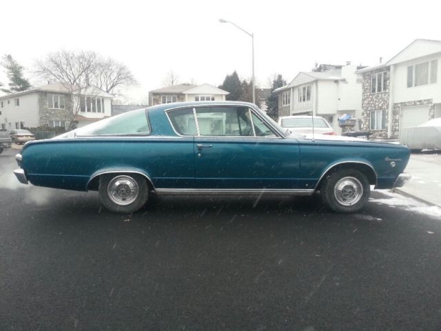

a 1966 Plymouth Barracuda which'll get converted to RHD. 5 litre V8 4 speed. should make an interesting tow vehicle for the S800.
knocked up a tool to measure bump steer as the steering linkage is getting changed
plenty to do.

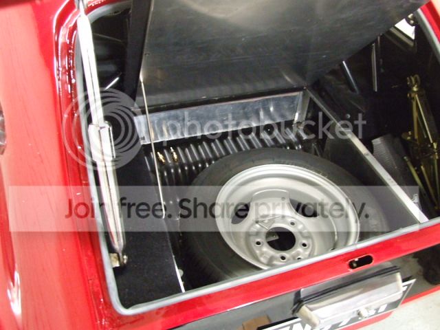

few years ago i made a boot compartment for the spare wheel as where that used to go will now be a pair of silencers.

they are the track wheels. the wheels in the Avatar picture I still have. they are British made alloys. and I also have a set of standard wheels if I want to tone it down a bit.

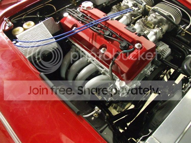

I was never quite sure with the original exhaust manifold I made so I scrapped it and remade another one.
quite easy with available parts. (i'm also going to make headers for the Barracuda hence all the extra bends)
iv'e had the whole exhaust system metal sprayed to keep the rust at bay.

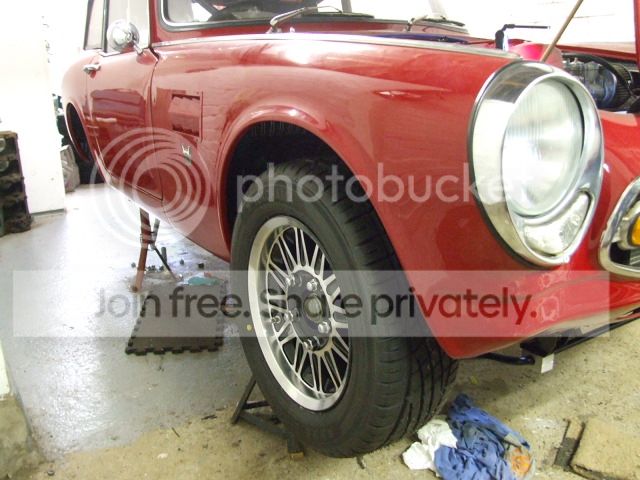

I know it's a lot of work just to be able to fit the standard wheels and will probably spend little time with the standard wheels on anyway.
it's very tight but will work. Just need to make the brackets to weld to the axle.
loads of clearance with the 13 inch alloys.

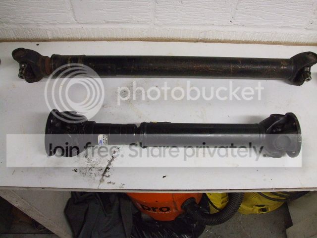

prop-shaft was stroke of luck. non standard vehicle at work having a different gearbox fitted required a different prop-shaft. the old prop just happens to be the right length and flange type to fit my S800. a deal was done with the prop in exchange for a little machining job. :) (the longer one was going to be my mockup prop from an E Type Jag)

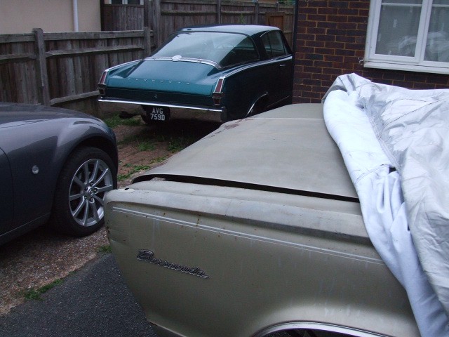

I decided Two projects wasn't enough. so i bought a second Barracuda.
it wasn't supposed to be a project but i just cant leave things alone
still, at least i can swap bits between cars. the Gold car will be the modified car and the Blue one will remain standard.

Oh and I also have another project on the go
plenty to do.

and Recommissioned this pictured Ford in 2010/2011. spent 30+ years in the Beaulieu Motor Museum. Looked after it at Goodwood ever since.
Bling !
when I bought it in 2007. (was a cheap car then)
long over due for an update.

The rear brakes were proving to be a bit of a hurdle. I wasn't happy with my original plan of the Cortina P100 drum brakes. (came with the axle bits I acquired) New drums are proving impossible to find and are really heavy anyway. so a rethink and hours of internet searching and I have a plan.
Mk 2 MX5 calipers are easily available and only £75 new. the discs are Honda Civic circa 2002 and again cheap and easily available.
Bit of machining to the disc.and it'll fit. The calipers are quite small and it all fits under the standard wheels. result.
no point worrying to see if the Porsche wheels fit. I made the axle 20mm shorter than the S800 unit so wider wheels will fit without sticking out and will space the wheels as necessary. With the beefier wheel studs it wont be an issue.
