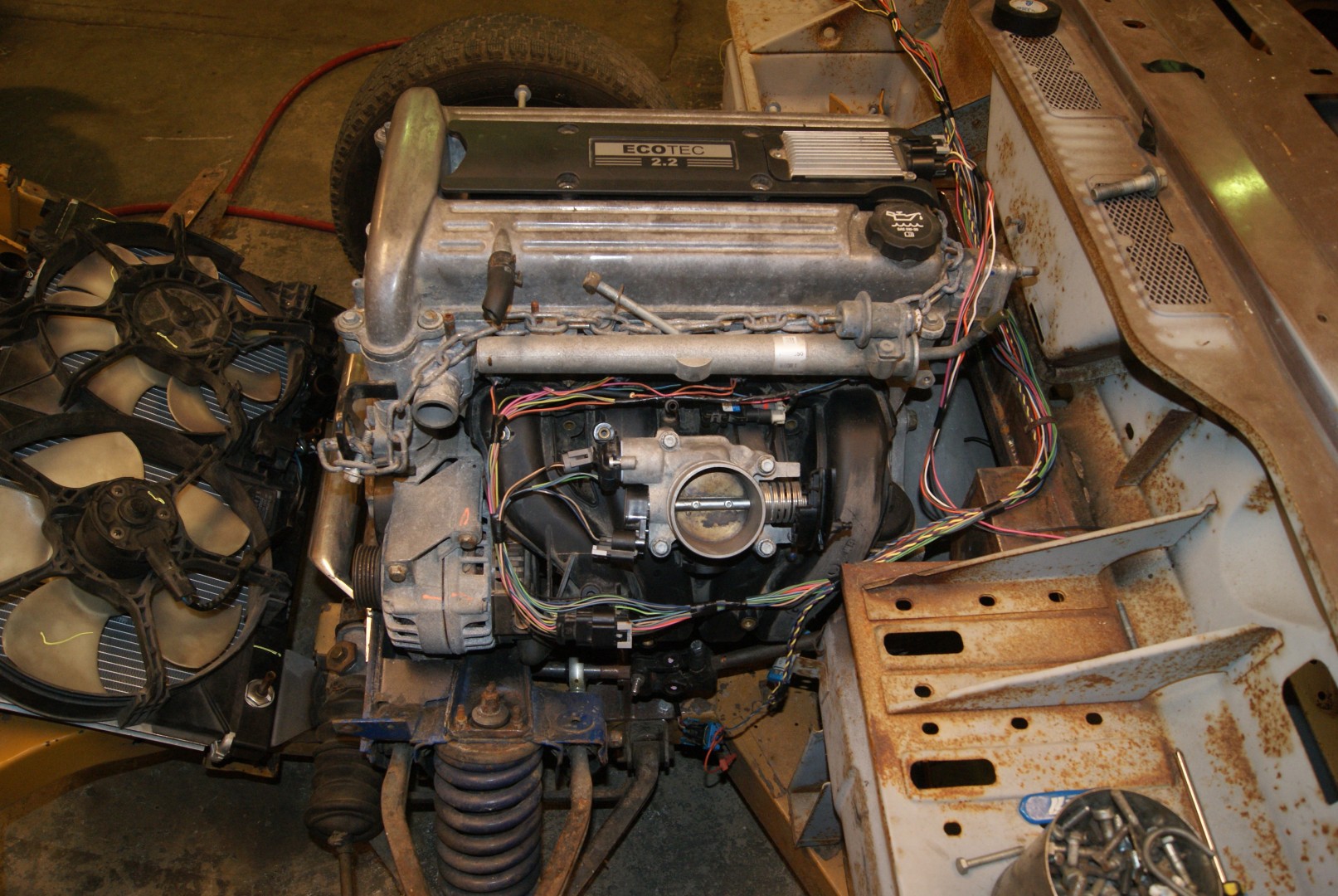

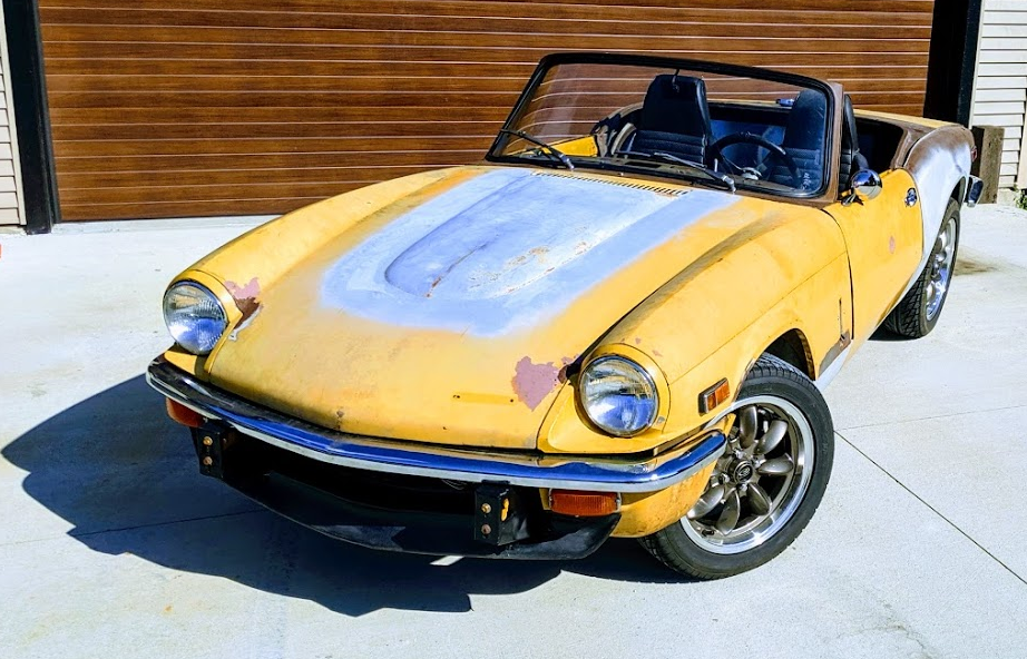

Except the engine. And the transmission. And the electrical. And several of the ancillary bits.
The car is a '72, and I bought it from a the wife of a gent who passed away shortly after disassembling the whole car. This wasn't a problem given it's not my first Spit. Or my second. It's the third. The first one I did a "refresh" on when I was in high school. The car was only about 10 years old then (it was an '80); new paint, interior, trans, differential and body-off-frame clean up. 2nd Spit was a '78 I bought myself as a toy. I ended up building a fuel injection system for it, including the intake, controlled by Megasquirt and Spark. I still have this car, but there is a tiny man with a hammer inside the crankcase who gets angry and bangs on the engine with his hammer when I start the car. Or I have a rod knock. I haven't looked yet.

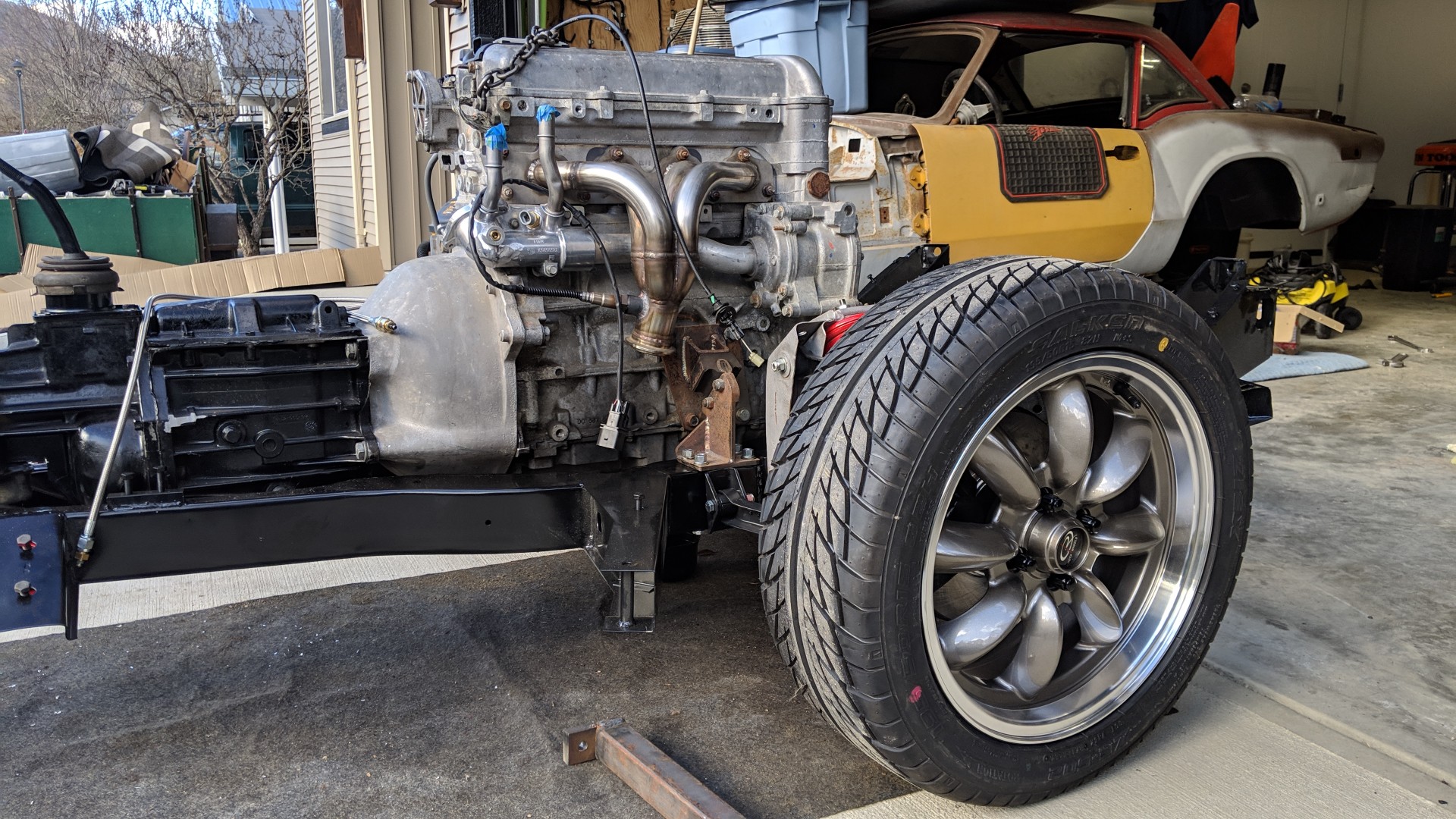

The 72 is getting a GM 2.2L L61 Ecotec and a T5 trans. It's not quite as tight a fit as PB, but it does present its own set of challenges.
To be quite honest, I have NO IDEA why it took me so long to find PB. So many of the things Nik and Richard are doing are the kinds of things I want to do to my Spit... but with a tiny fraction of the talent. But now that I have watched the series, it has re-lit the flame to get to work on the car again. I also plan to shamelessly steal some of their ideas.

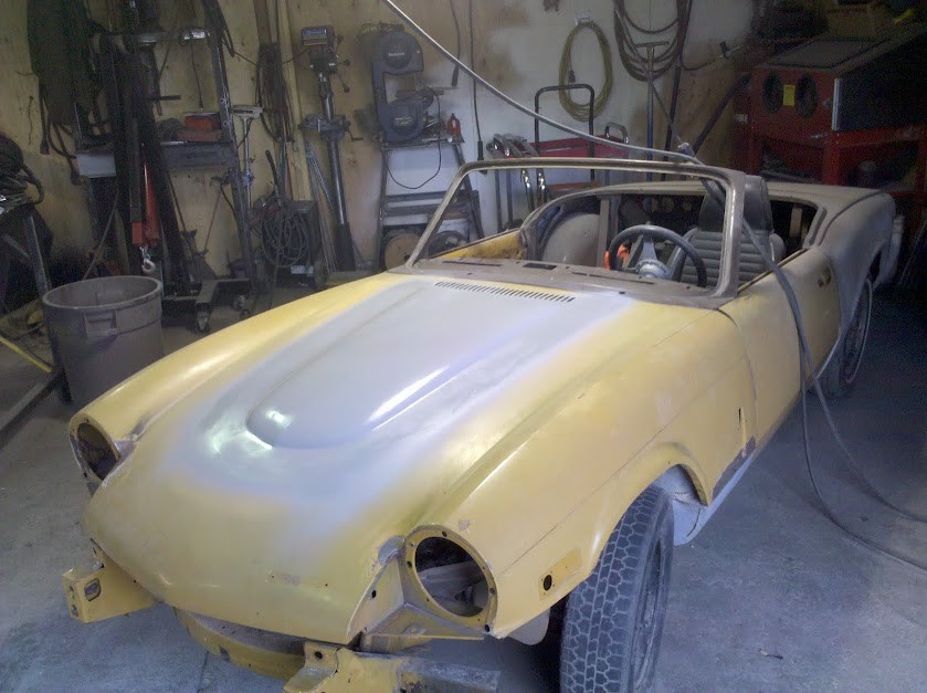

There had to be a bump in the bonnet if the engine was to not leave holes in the road.
I'm an electrician by trade; wires don't tend to worry me.
As you can see from my garage I may suffer from some kind of mental disorder.
Also, when cats learn to drive I'm totally walking all over their cars.

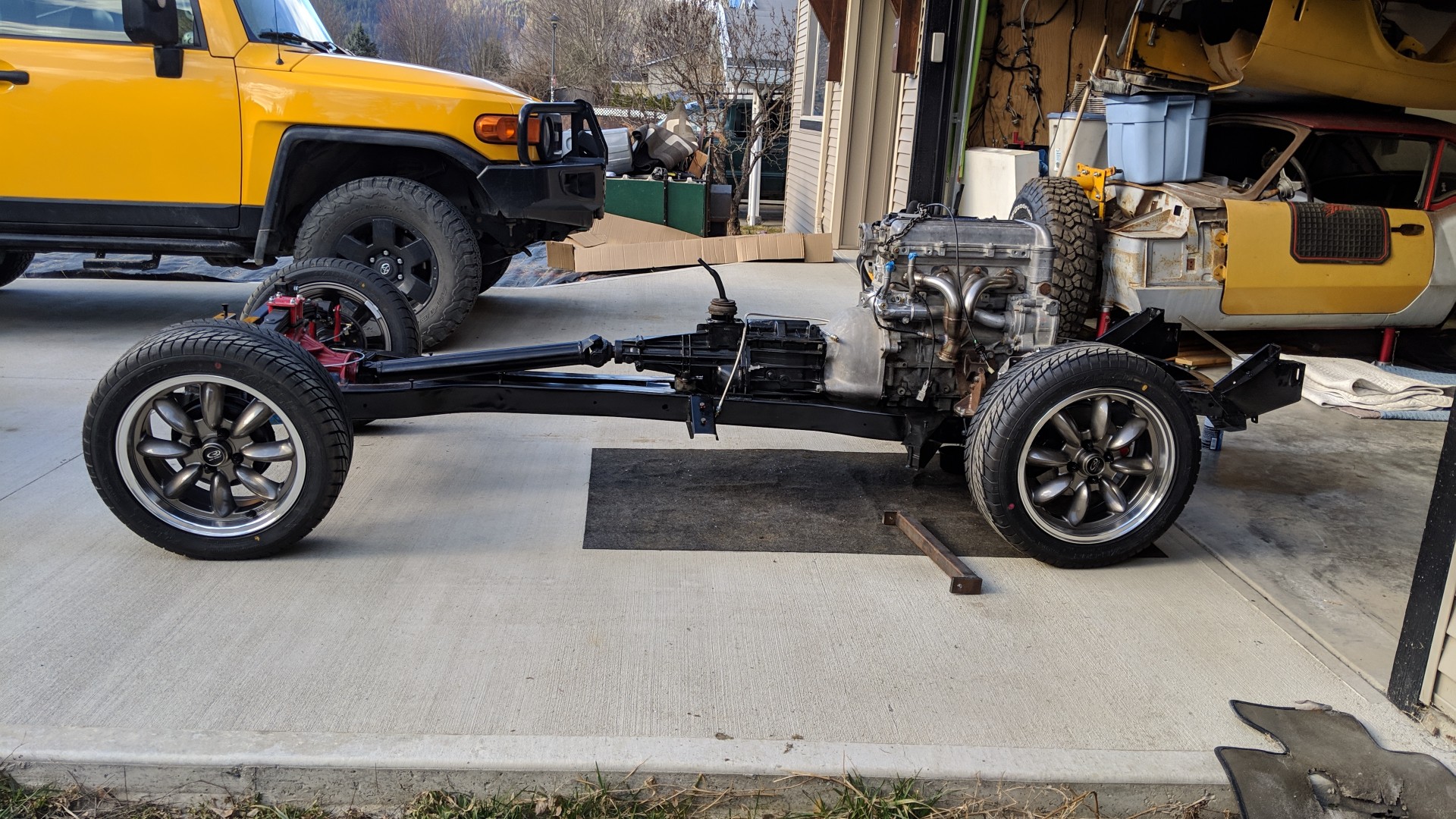

Mar 28, 2019

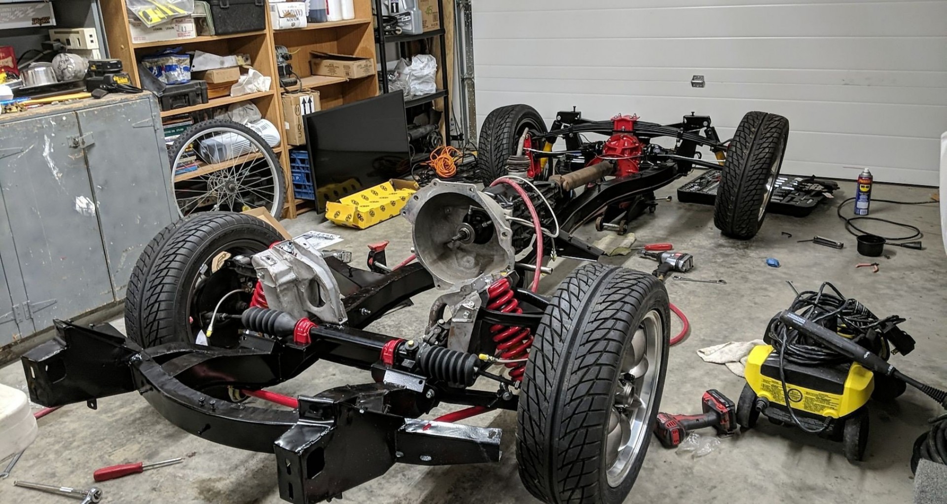

Some progress has been made!

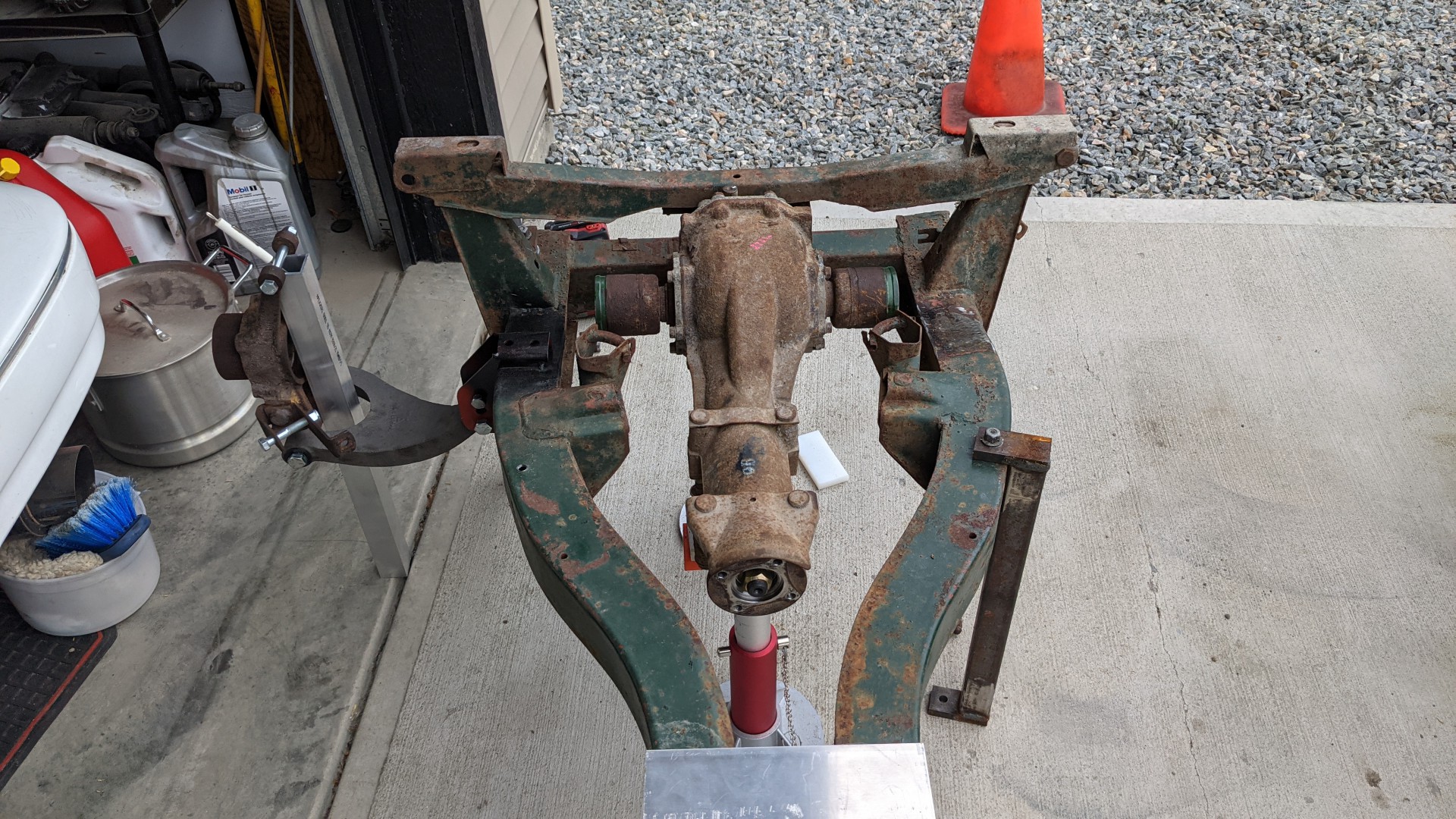

Are you using standard Spitfire Mk4 rear suspension?
DanN said
Jun 6, 2019
Well.. for now, anyway. I may in the future switch to something different, perhaps rotoflex based with a Subaru diff or maybe something different entirely. If I do go that route it would have to be with CVs and not the rubber donut.
I made the decision a while ago that if I was ever going to be able to drive this car in my lifetime (and in my budget) I'd have to stick with the stock rear for now. And truth be told, I like the way the rear handles as it is - it's only the differential that I'm not happy with.
I have gone with swing spring and the later, wider axles and all GT6 brakes. We'll see how long the diff will survive; probably 100% right foot dependent.
DanN said
Jul 2, 2019

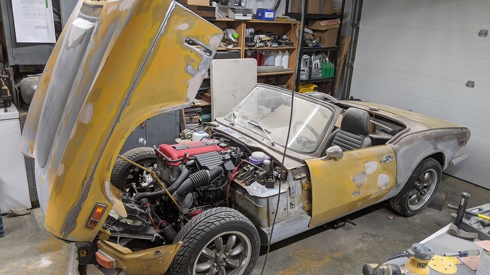

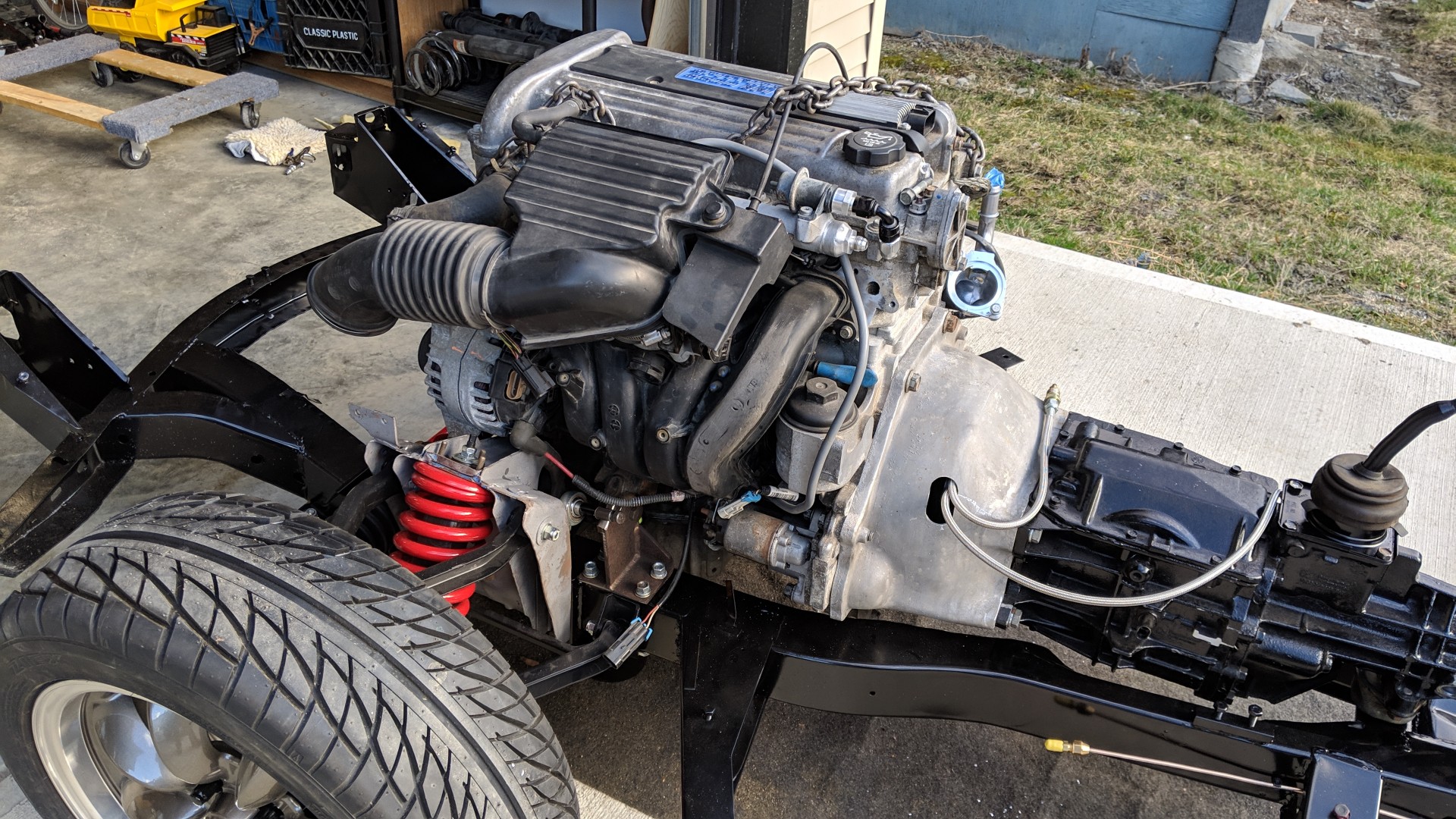

One step closer to the edge!

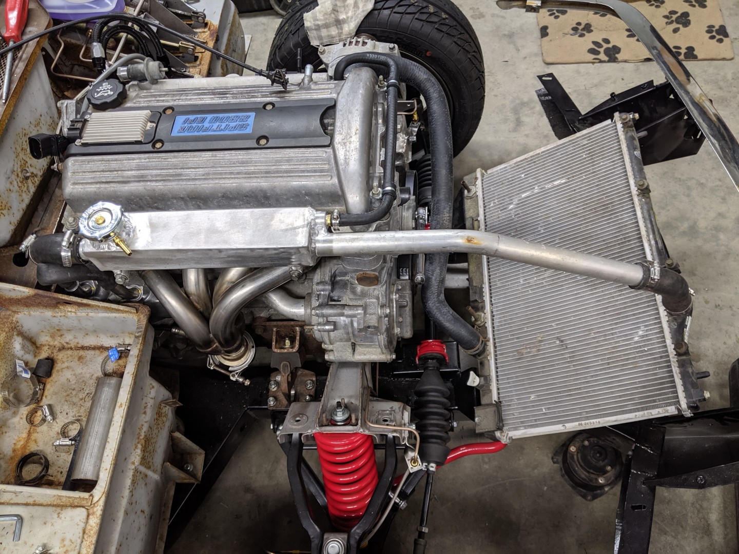

For the first time ever, power (sorta) from the engine turned the rear wheels. Unfortunately it was just the starter motor, but we'll take the wins where we find them.

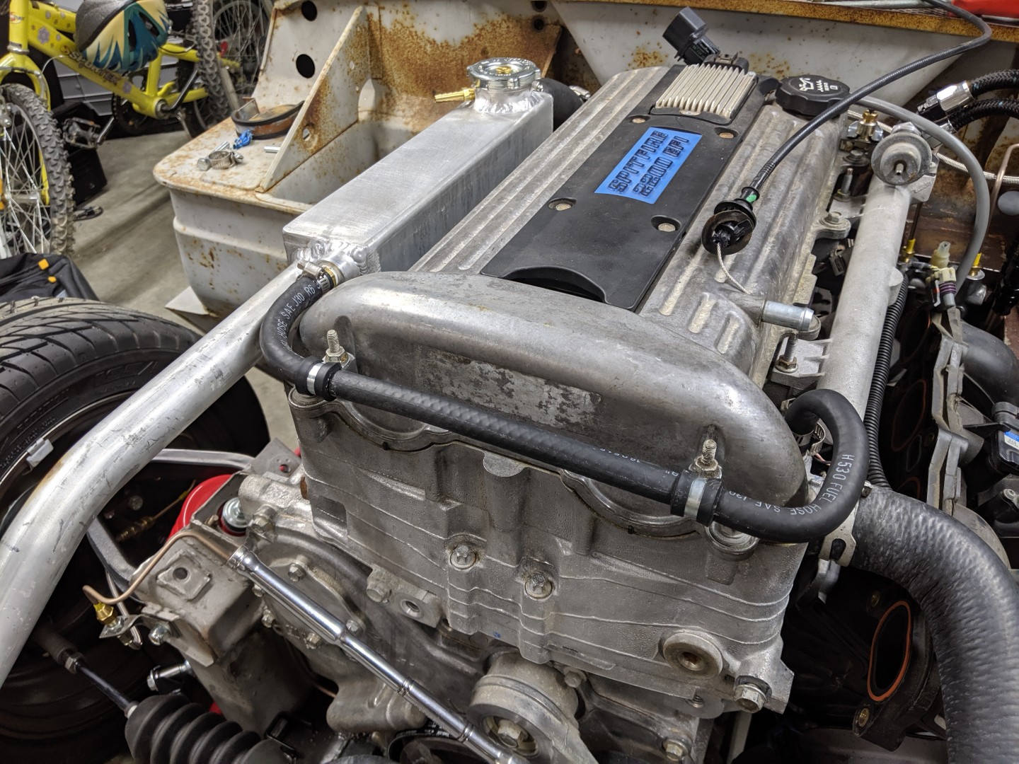

Cooling system almost done, and thank it wasn't nearly as tricky as PB. But no AC or boost make it considerably simpler. The hose clamps I've used aren't ideal, but they are what I have right now.

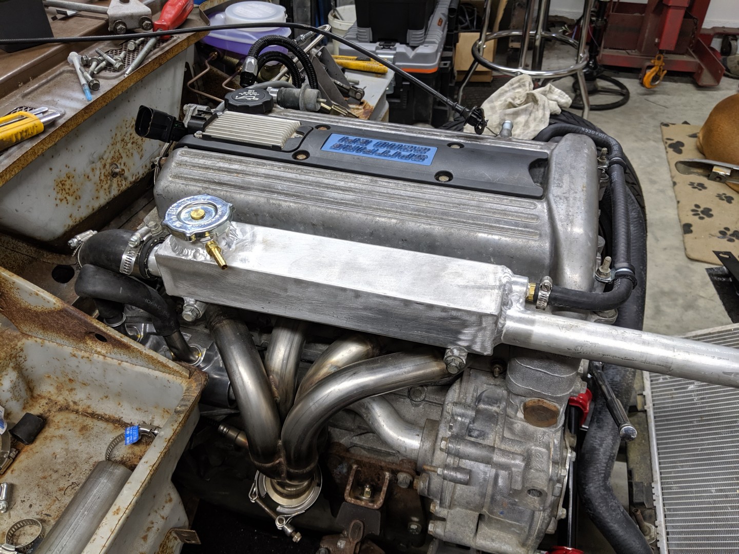

Is vibration going to be an issue with the weld on the long pipe off the coolant tank?
DanN said
Aug 28, 2019
It's made of some pretty heavy material, so probably not.. but I'm going to change it anyway. I have to pull the header tank off to make some other mods, so I'll change it then. In the meantime, it's working - so it's a little low on the priority list for now.

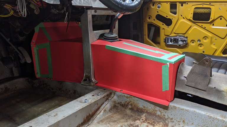

Been working on the tans tunnel... it would be really cool if BOM did some CAD tutorials.. :D

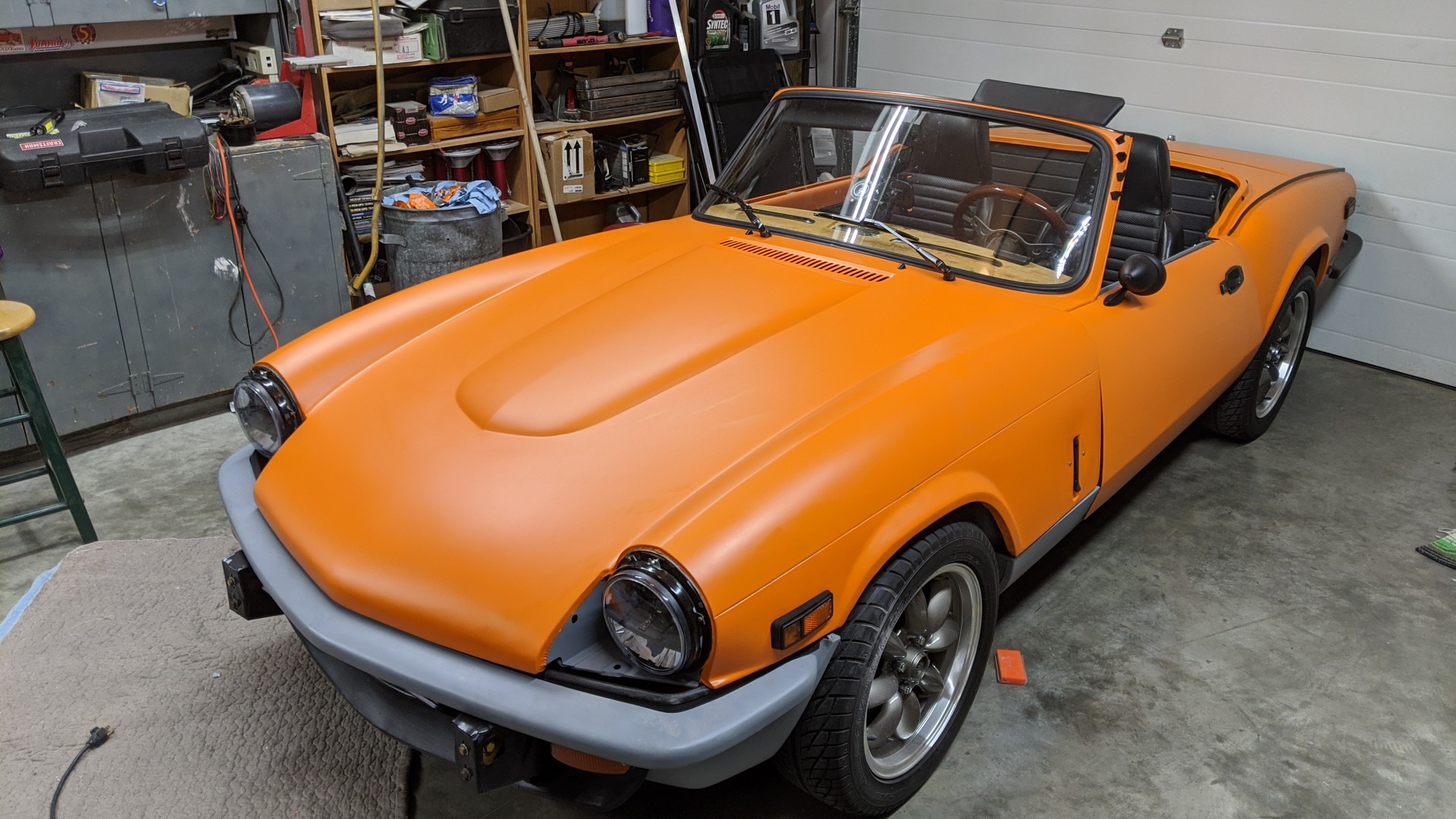

I like the color, is it paint or a wrap? In fact, I like the entire build so, more photos PLEASE!

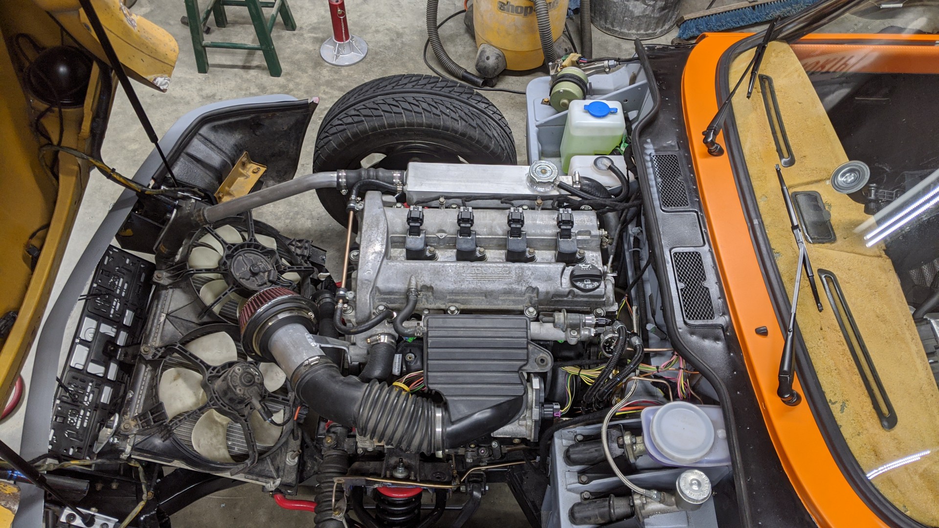

The original L61 was from an '05 Pontiac Sunfire; it turned cannibalistic and ate its own balance shafts while I was on a short road trip - about 25 miles (this was the first "long" trip with the car). They were clearly oil-starved, but I don't know what caused it. The oil pump looked good and there was plenty of oil in the pan.. oil that was quite pretty with all the aluminum sparkles in it! I wasn't pushing the car hard, but I was running at highway speeds for about 30 minutes. The lesson I learned was that I needed a proper oil pressure gauge, which the car now has (though the idiot light never came on, so.. I dunno). I chalked it up to the fact that the engine sat for nearly a decade after I originally collected it for the project, and maybe it had a mud wasp living in an oil gallery or something like that.
I picked up a newer second gen L61 from an '07 Pontiac - better cams, rated a little better power wise. Unfortunately it turned out to not be compatible with the original ECU I had - it couldn't see the crank pulses. Or maybe it could see them, but couldn't use them. I wasn't too heartbroken about it because the original ECU was pretty much an antique by tuning standards - so much so that you had to have a Windows XP computer to tune it at all, so it was an upgrade I wanted to make anyway. I had taken the factory ECU for that engine and it's related components when I pulled it from the wrecker. I picked up an HPtuners programmer with a couple credits and set the ECU to run standalone with the factory tune. It runs really nice. It's headed for the dyno on May 28 (just over a week from now), so it should be even nicer. We'll see how long the poor Triumph rear end survives.. I really hope to not see the death of it on the dyno though. HAHA. I have picked up an R160 rear from a Subaru to see if I can make the driveline angles work - but it will mean a complete rear end conversion away from the original swing axles. Stay tuned..

It is indeed a wrap. For about $150 CAD I figured a wrap would look better than primer for a couple years until I could "afford" to get the bodywork done properly and have it painted. The plan was always to make the car as orange as I could get it, but I never considered a matte finish. Gotta say, I love the look of the colour and matte finish. I'm not a big fan of how the wrap turned out, but the majority of the issues are based in my inexperience applying wraps. It's pretty obvious that I had never done it before. I suppose you could say that a wrap is something a patient novice can do, and that it looks pretty passable at 30 MPH. But if you get close you'll notice a few wrinkles, bubbles and spots where it's not adhered well and starting to come up. Like any body work, prep is key. And good primer. Cheap rattlecan primer will sometimes pull up and stick to the wrap when you reposition, and you can't get it back off the wrap 100%.

I thought it may be a wrap, it looks good to me. The only giveaway was the wrinkles at the front corner of the hood by the headlight, and you wouldn't see them when assembled.

The closer you get to the car, the more obvious it's a wrap. LOTS of imperfections. But it's not intended to be permanent, it is just to get a feel for the colour and make the car uniform until I can afford to have the bodywork done. I seriously don't have the talent for panel work. But for about $150 Canadian in material and a few hours with a heat gun (and zero previous talent) I think it turned out pretty well.

The engine has been swapped to a Supercharged LSJ 2L - same architecture as the Ecotec that was in it, but now with only 2L and 11# of boost. Power should be around 250hp.

CAD Design. I didn't end up using it because once I had it to test fit it was clear it wasn't going to work. But that's the point of CAD, right?

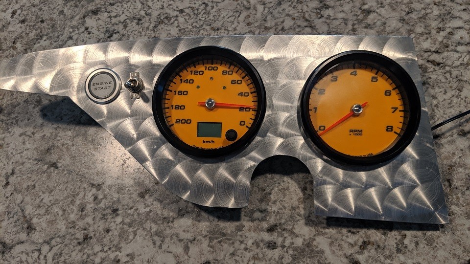

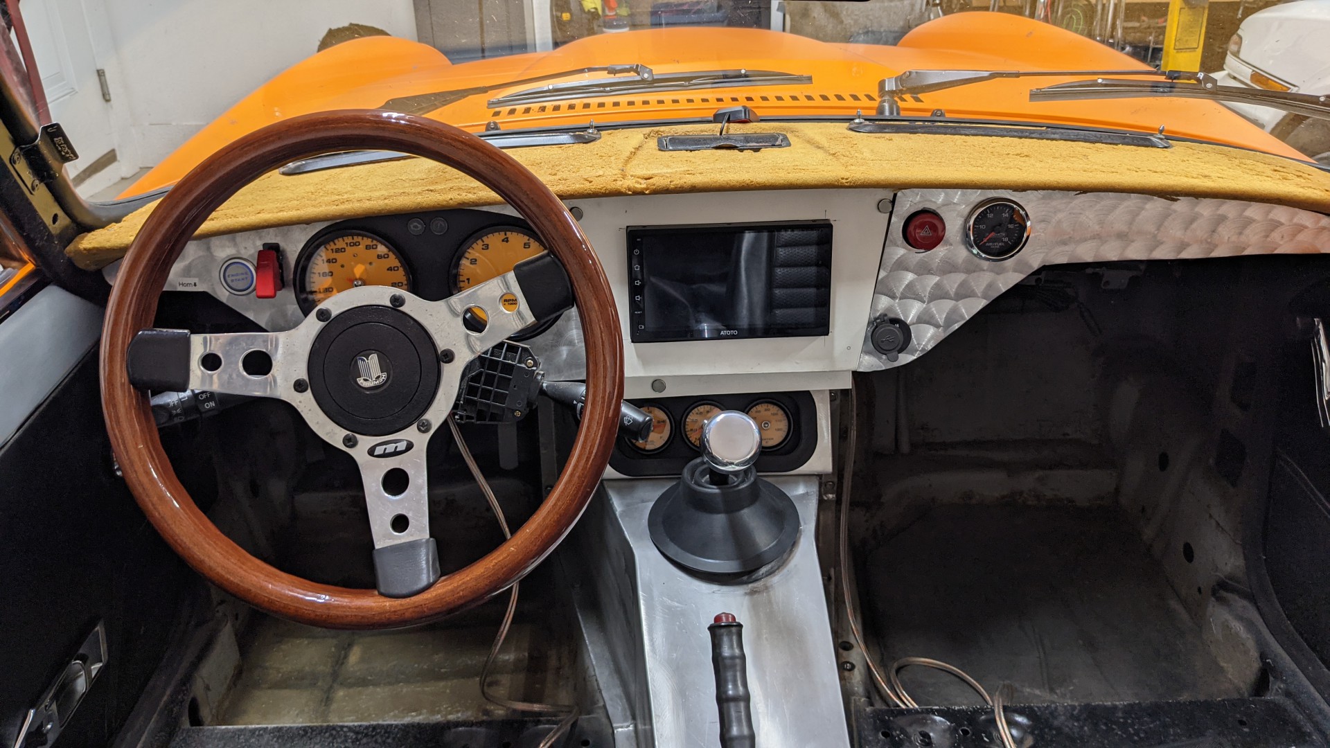

Not bad for a temporary dash I think.
It's starting to look like a real car! (With really bad paint.. hahaha)
Agreed, Fusion 360 is beyond both me and my PC, BOM CAD is more my speed!
It looks as though you've got a handle on it!

Bodywork is not my strong suit.
It sure is fun to drive! Even if I did have to completely replace the motor and ECU after 300km.

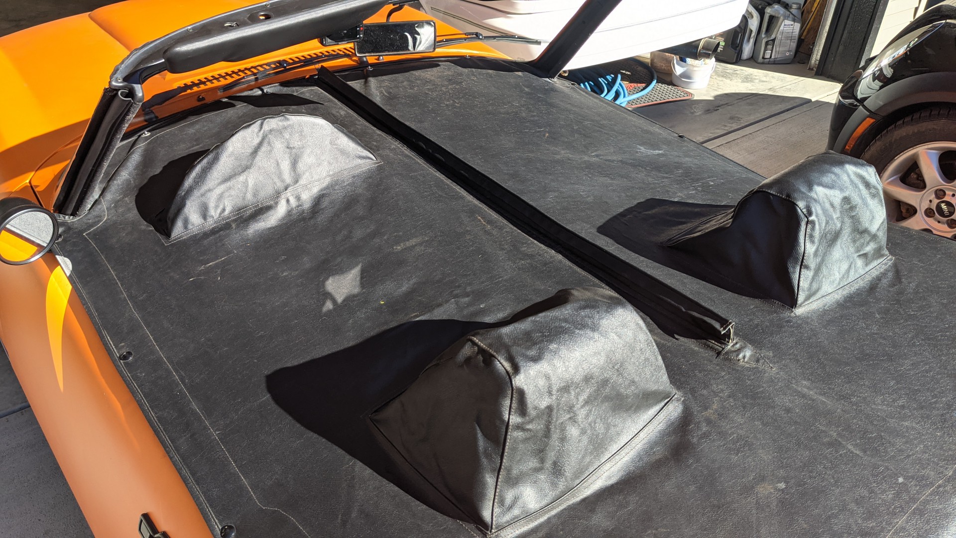

Bit of an update for the spring of '21.

What brought about the motor & ECU replacement?
Hi GrayRaceCat!
This is the vinyl I used: https://vvividshop.ca/collections/automotive/products/orange-matte - it is actually pretty nice stuff to work with, and adheres amazingly well (when applied correctly).

I only just saw your reply today (28th). Thanks for the answers.

The car now has power steering, GT6 rear brakes and a Subaru R160 in 3.54:1 and a VLSD.
