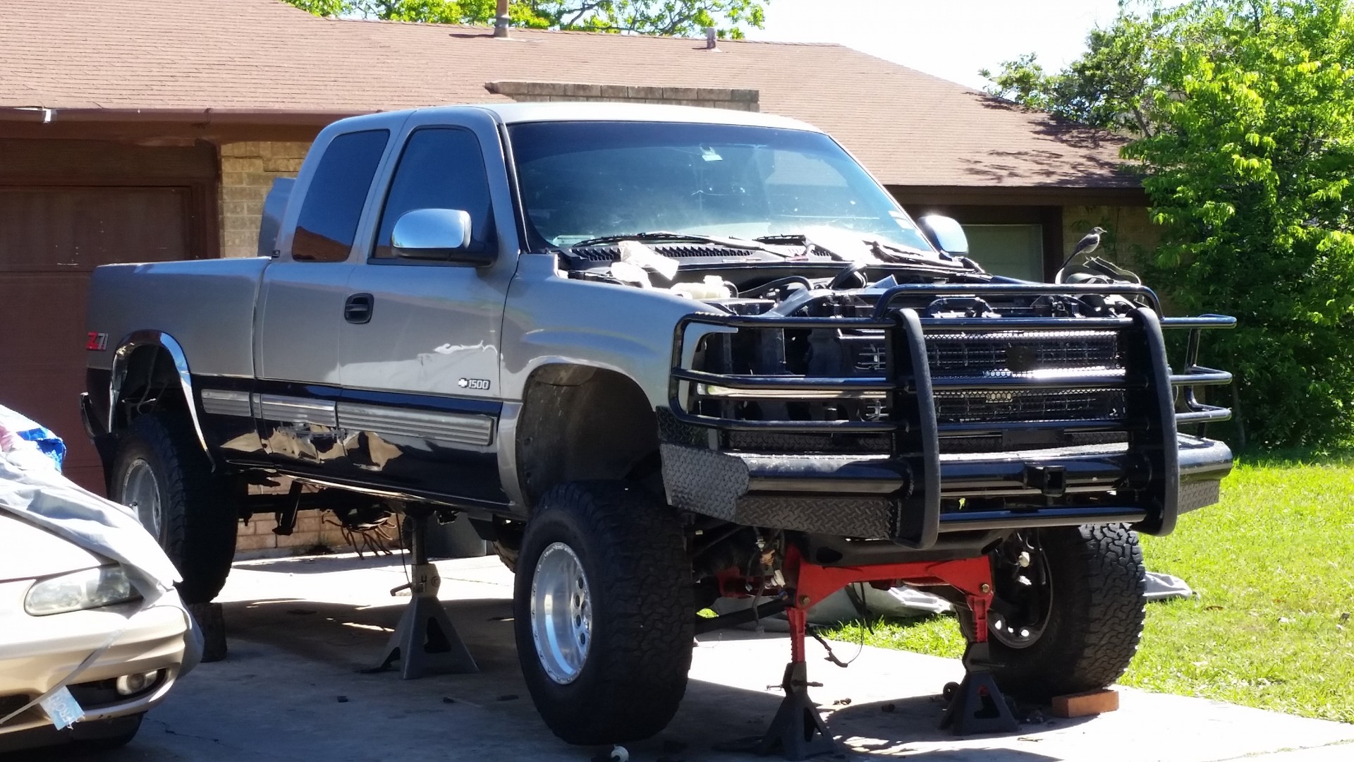

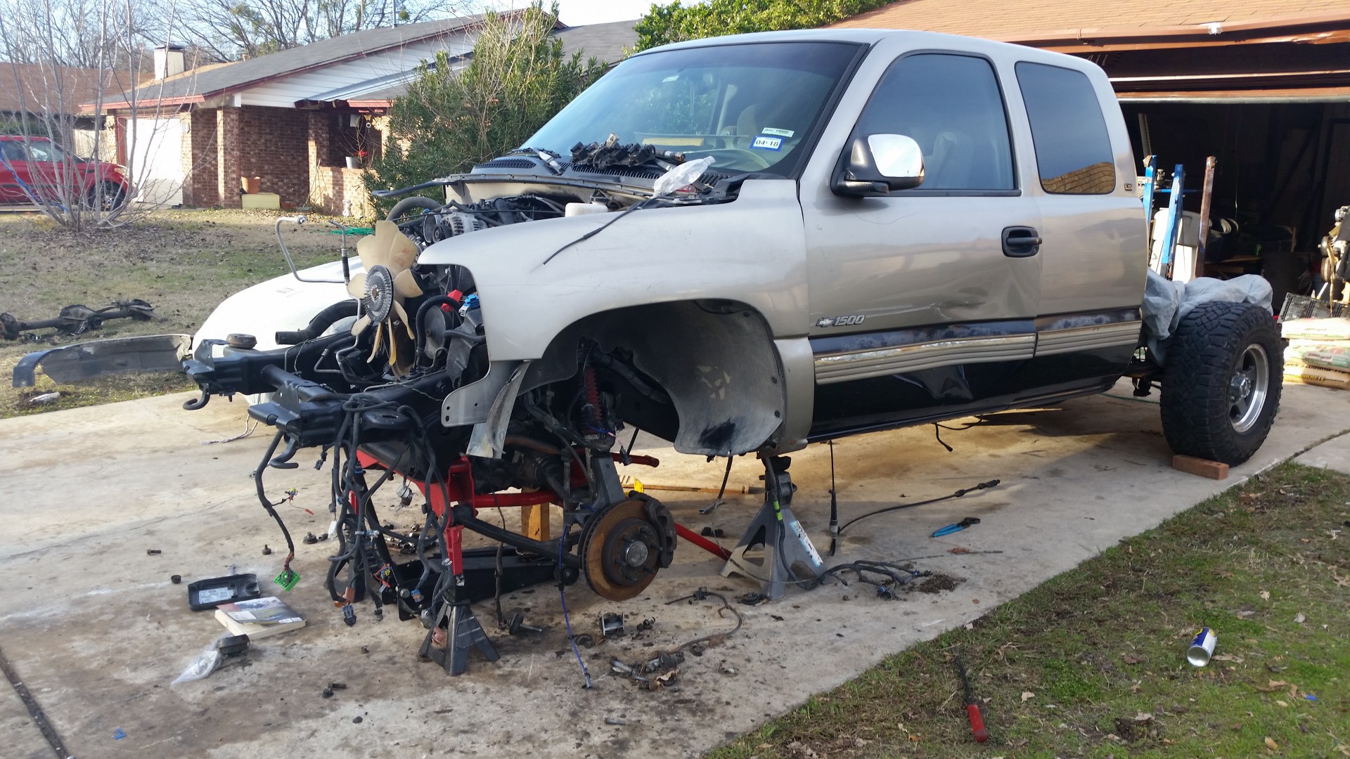

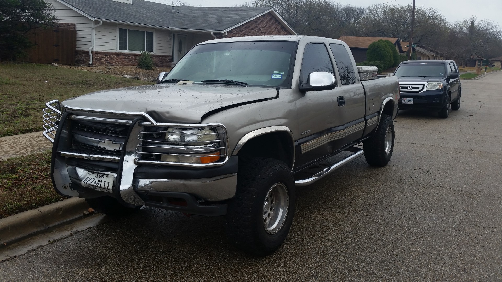

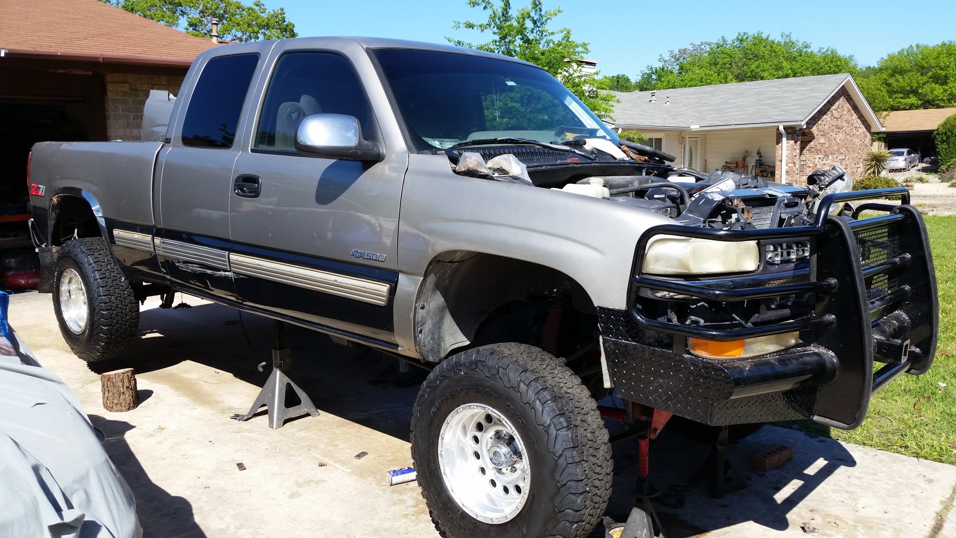

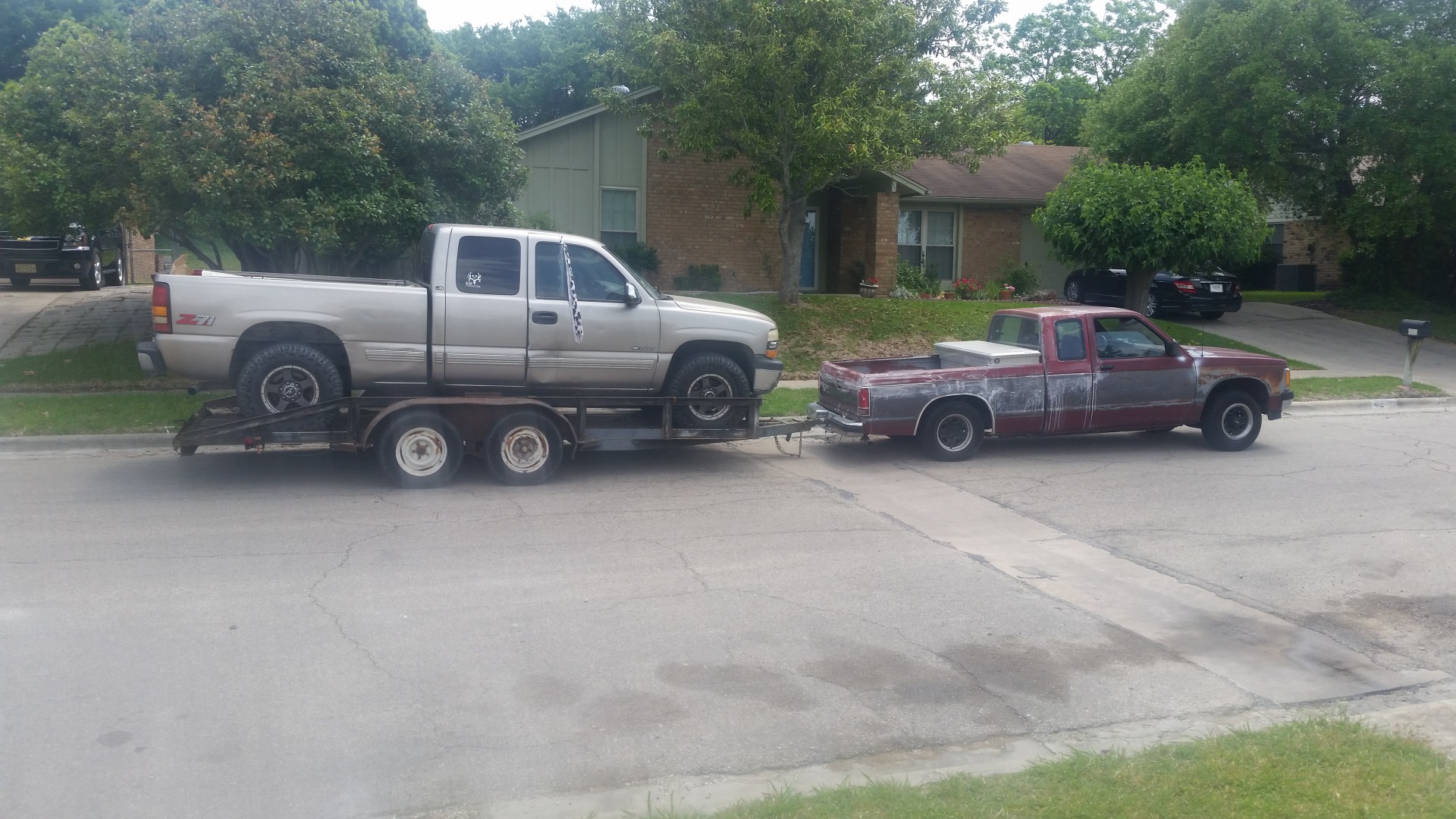

Because of the madmen of BOM and my own lunacy, when my truck got wrecked, I had to rebuild. What started as a work truck ended up as a fun go anywhere, do anything land beast. Happily driving along, I had a wee little thing jump in my way and physics being what it is, I took it for a ride which put a nice bend in my frame. Not having near as many toys as the builders of Binky yet, I had to buy another truck to pull parts from rather than attempting to fix the afflicted bent bits. Now that I've got things mostly apart, things are starting to snowball, bigger engine, put shiny new bits in the diffs, little welding here, bit of grinding there, learning that Blackhurst is really good at both of those, making it look much easier than it is and I need more practice and an electric kettle may be needed and making it more of a monster on the road than it already was.
Before and after the toyota, more to come as it gets done.

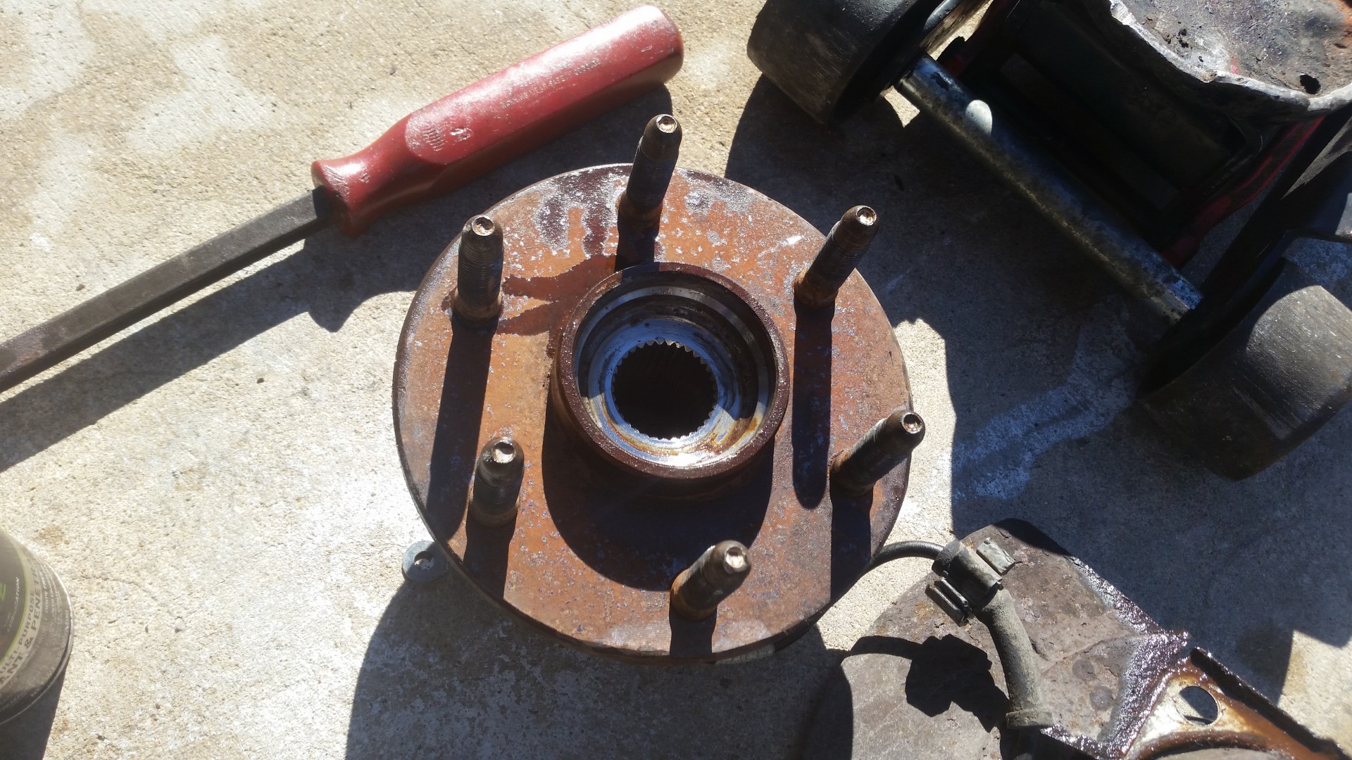

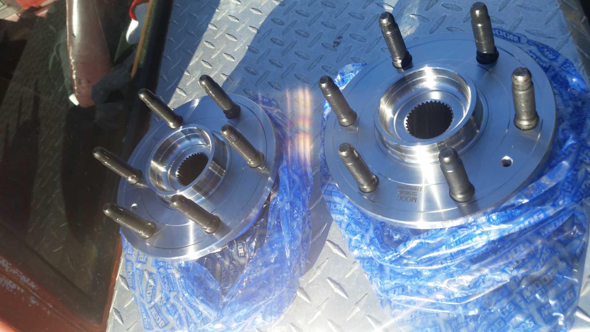

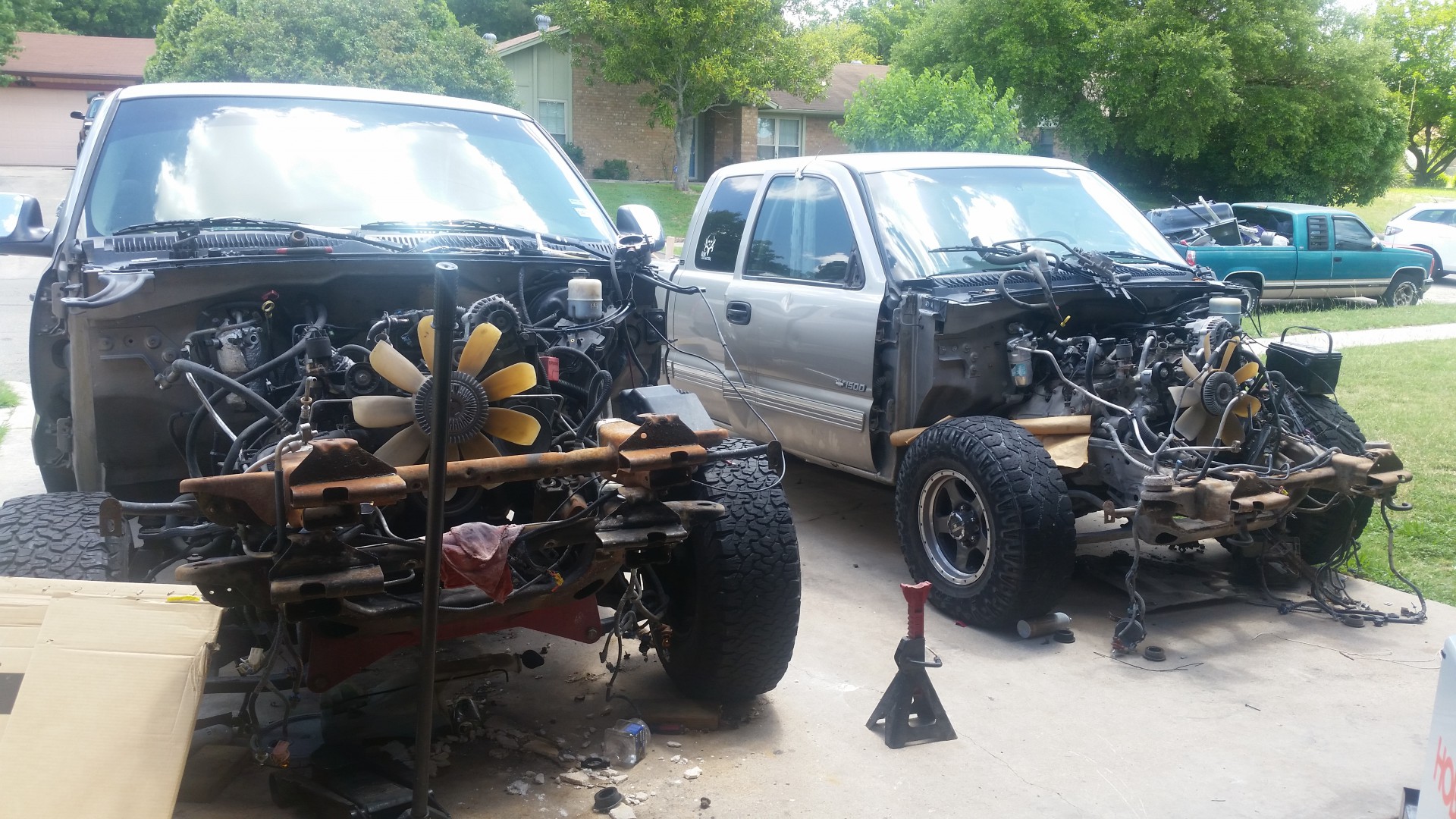

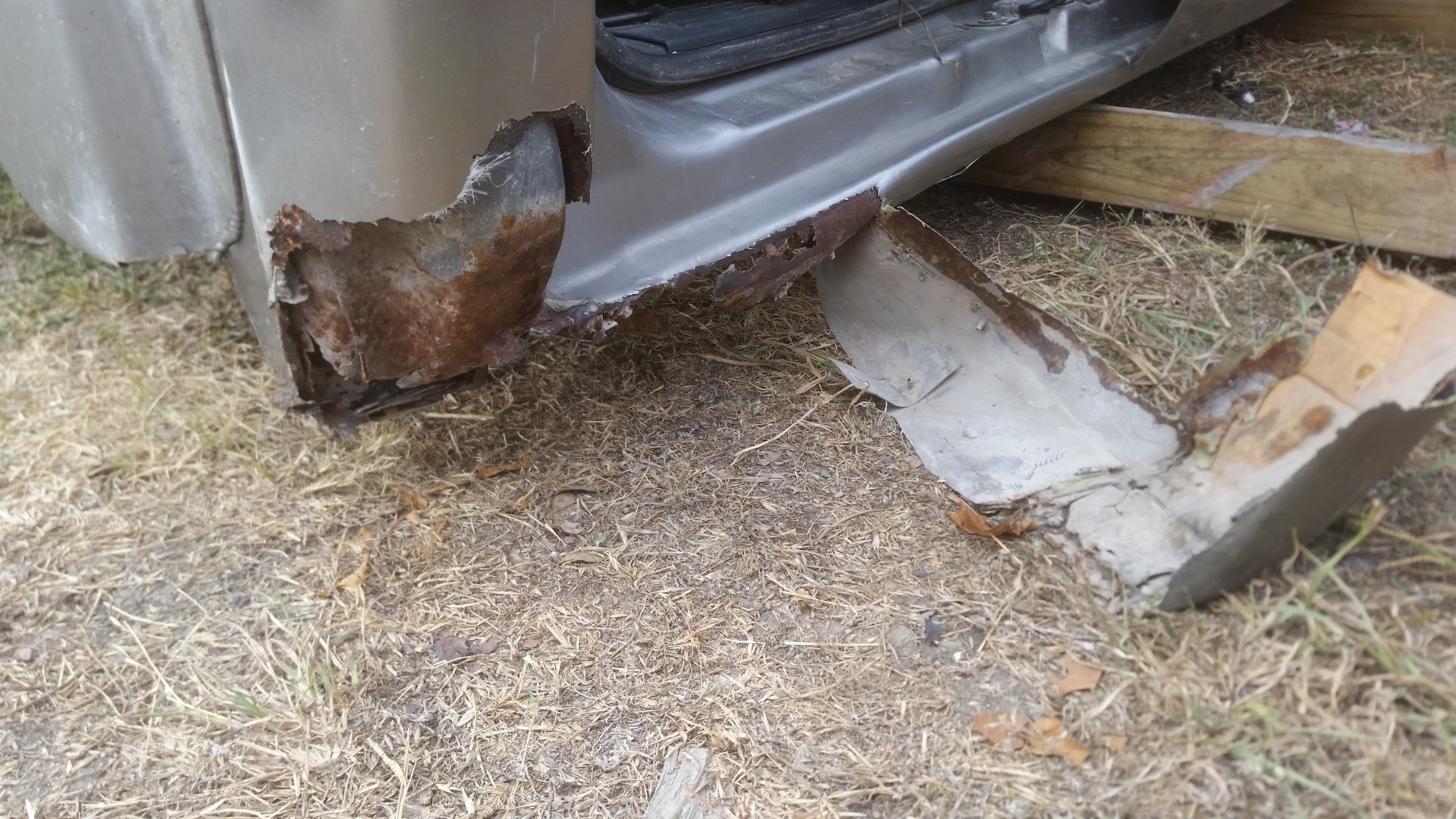

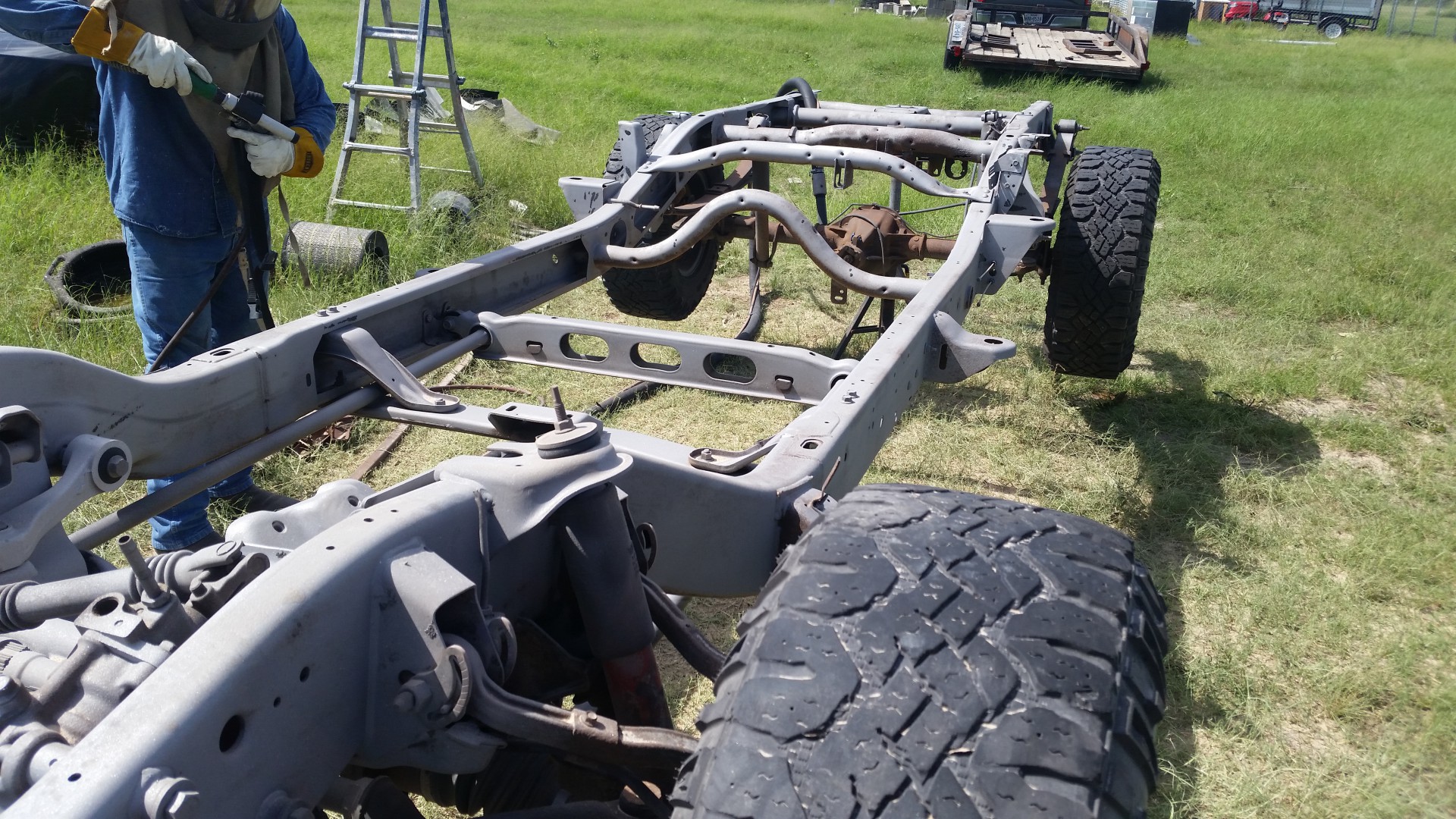

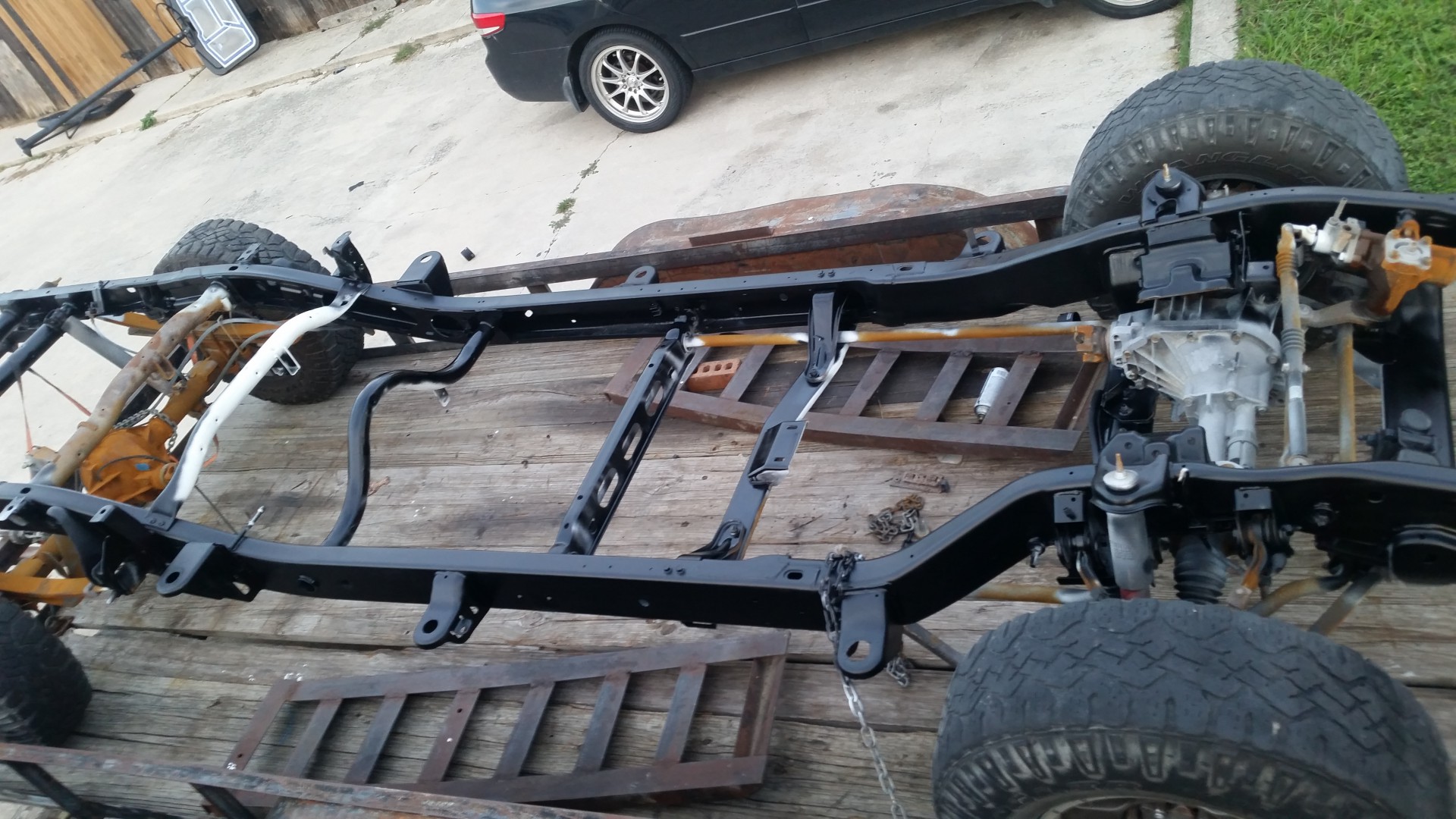

So, as promised, more was done, progress being put here, the donor frame has been sandblasted (done before the first post... shhh). The frame has been painted, the cab has been shifted over, woo!

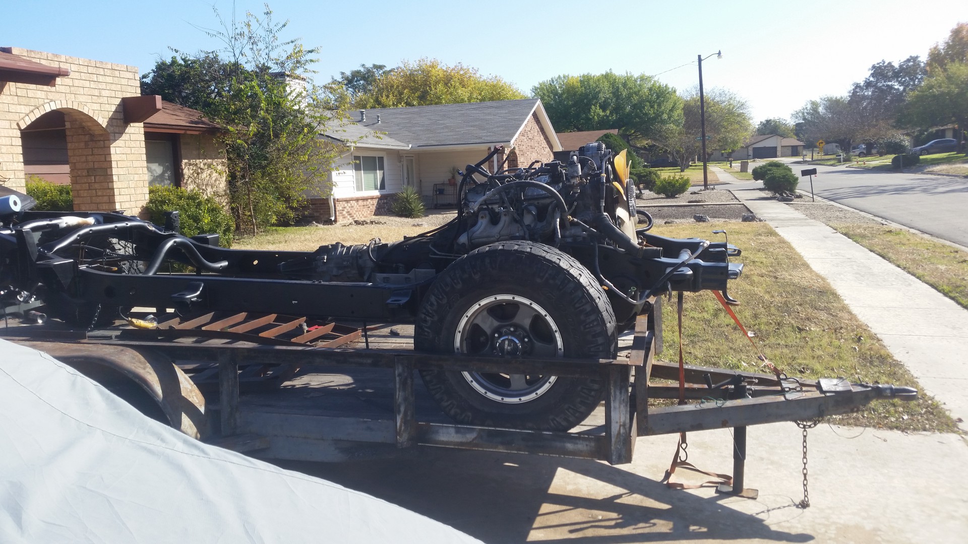

As of now, the front suspension on the donor is ready to be hauled off for scrap, rusted pile of parts that had to be VERY forcibly removed, the lift has been shifted over with much frustration over a minor misalignment with the mounting points. I mean really, 1/8 inch out on ALL points? I did have the sense to wash the road grime off the parts that were to be installed. Try as I might to keep it clean, there's just some areas that don't allow much room for a good scrubbing and this seemed a cherry time to do so. The new hubs need to be bolted on, much shiny, but after the suspension adventures.... Let's just say it was time to walk away for the day. New hubs as mentioned only a moment before were acquired since there was doubt of the condition of the old ones and they can be slipped on and secured without difficulty after work tomorrow and for the first time in months it will start to come together in a visible way and there will be abounding giddiness amongst my neighbors. I will have pictures and a brief synopsis of my adventures with the lift and the front diff come the next posting.

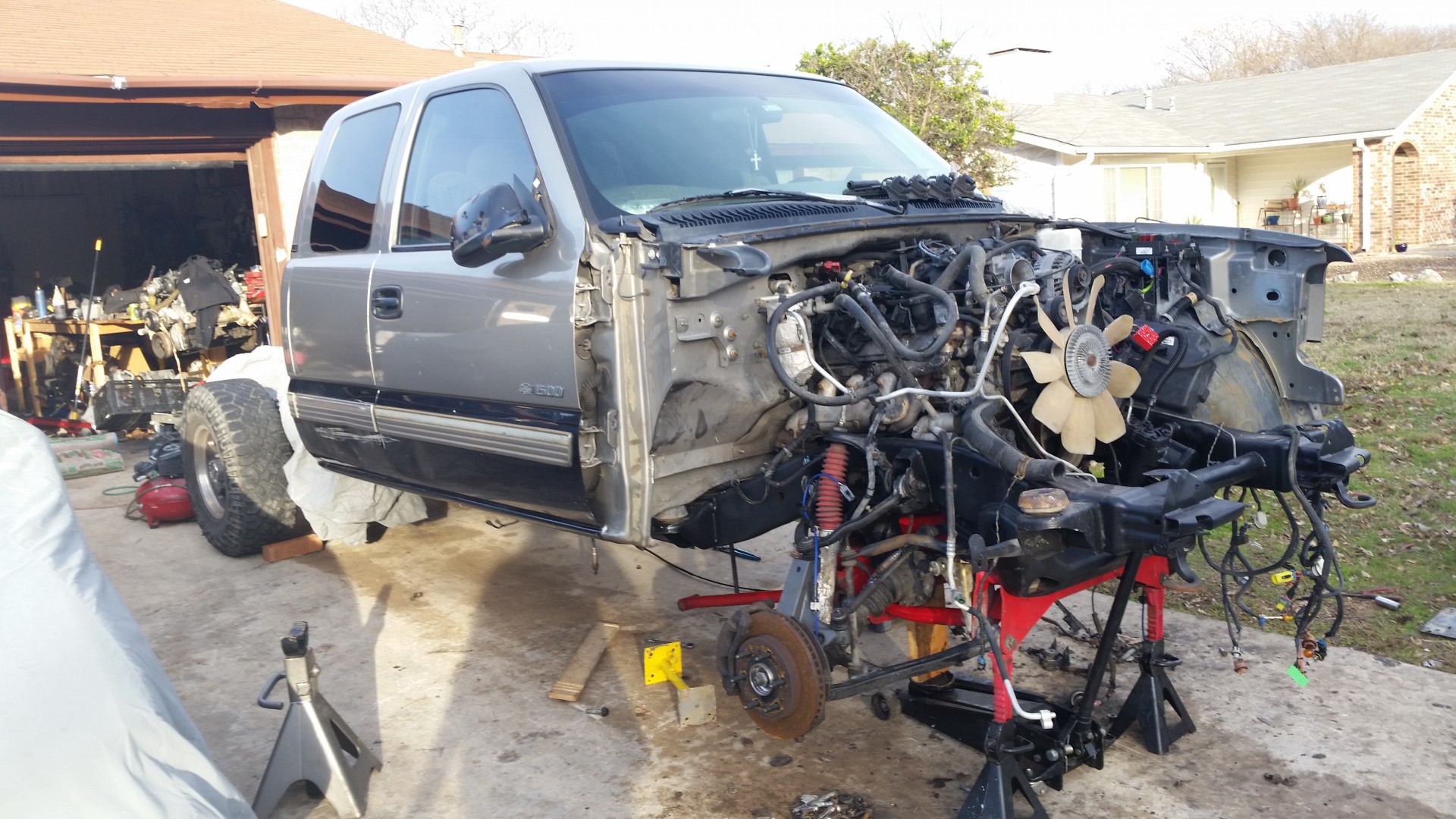

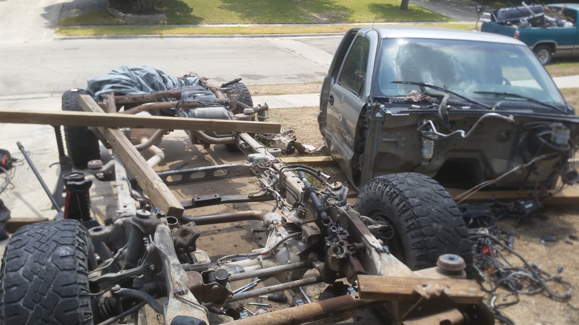

A pile of pictures, not the best but mostly in order I think. From getting the donor home to where it stands today, from fighting to scrap the scrap body to fighting the front diff and the lift kit. Many frustrations happened the day of the front suspension, including the failure of fire and the breaking of my favorite 10 lb sledge to remove the hub assemblies that decided to retaliate the neglect they had suffered by rusting themselves whole to the spindles that I had wanted to save (Did get them apart, but my poor hammer.) all the way to raising and lowering the entire front suspension and lowering it again about a half a baker's dozen times before figuring out that one of the mounting points on the front diff had to visit the saw and may still be where I threw it. The fuel lines and brake lines were especially fun being hard line that had to be finagled just so around the engine, transmission, quit hitting the transfer case, no, stop it, quit trying to take that with you. Was supposed to get the shift cable run and the driveshafts up, but I think it's time for a nap.

Hoo boy... it's getting ever closer. Just this morning the grille and really heavy bumper went on, fenders are on, actually on finally. Passenger side was removable for entirely too long for easy access to odds and ends. Learning far more about electrical systems than I really wanted to but there's not many surprises that beast has for me now. The front lights were an especially fun project since all reference photos were long gone so it was trial and error as we fought to figure out what went which where how and why and only had to run the same run of wires about uncounted times in uncounted configurations until it all laid out just so (taking far too long to do for as simple a job as it should have been). So very, very many trips to the junkyard for reference material and the odd bolt or screw only to have them found five minutes after we get back. Neat little note, the donor truck had a trans cooler separate from the radiator, where my wrecked truck's trans line ran into the rad, so I'm driving myself absolutely up the wall and back down again trying to figure out how to run the lines before I figured it out. But now it's bedtime, so have pictures and feel free to laugh at my troubles and shake your head when I say that hooking up the battery today, I crossed the positive and negative wires on the battery.
Sooo... I'm going to warn you here and now, the light is getting brighter still, the tunnel nearly traversed, and [insert dramatic music here] - it moves under it's own power now! doesn't much like to stop as there's a minor hiccup in the brakes that I should have anticipated, but it's fixable.
