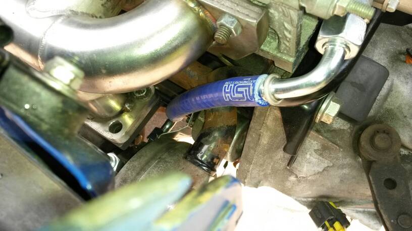

using silicone hoses to mock up to have braided made up

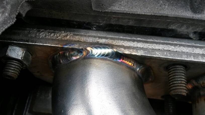

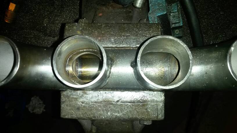

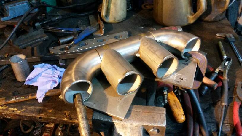

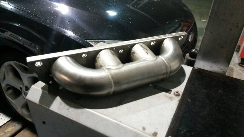

downpipe was made from all stainless just like the manifold but rest of the system is aluminium coated mild steel as i dont plan to keep it for long also 2.25" turbo back

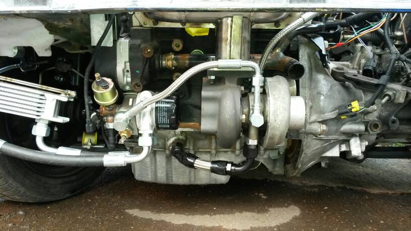

turbo in place all piping to and from turbo put inside heat resistant sleeving, also put a turbo blanket on to help with heat issues
she is tight
