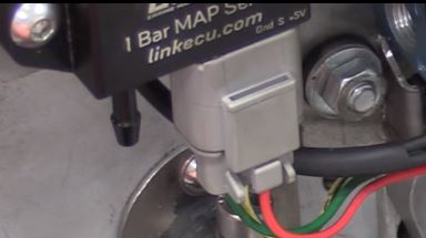

Unless things are a bit different over there, you have been showing a MAP sensor for an NA car.  I would think that you would want at least a 2 BAR unit, if not a 3 BAR.  Always nice to have a bit of headroom on the map, in case you just have to turn the boost up.  The ECu that I was using in the rally car would not go beyond the map at all, so once we figured that out, we decided that more sensor than what was absolutely necessary was a good idea.

1.0bar - And you fell for it!
Look closely there may have been the involvement of a Sharpie! I blame Ralph!

Definitely suspect, there are no 1 Bar sensors on linkecu.com, I suspect it's a 4 Bar with the "Sharpie" option.
